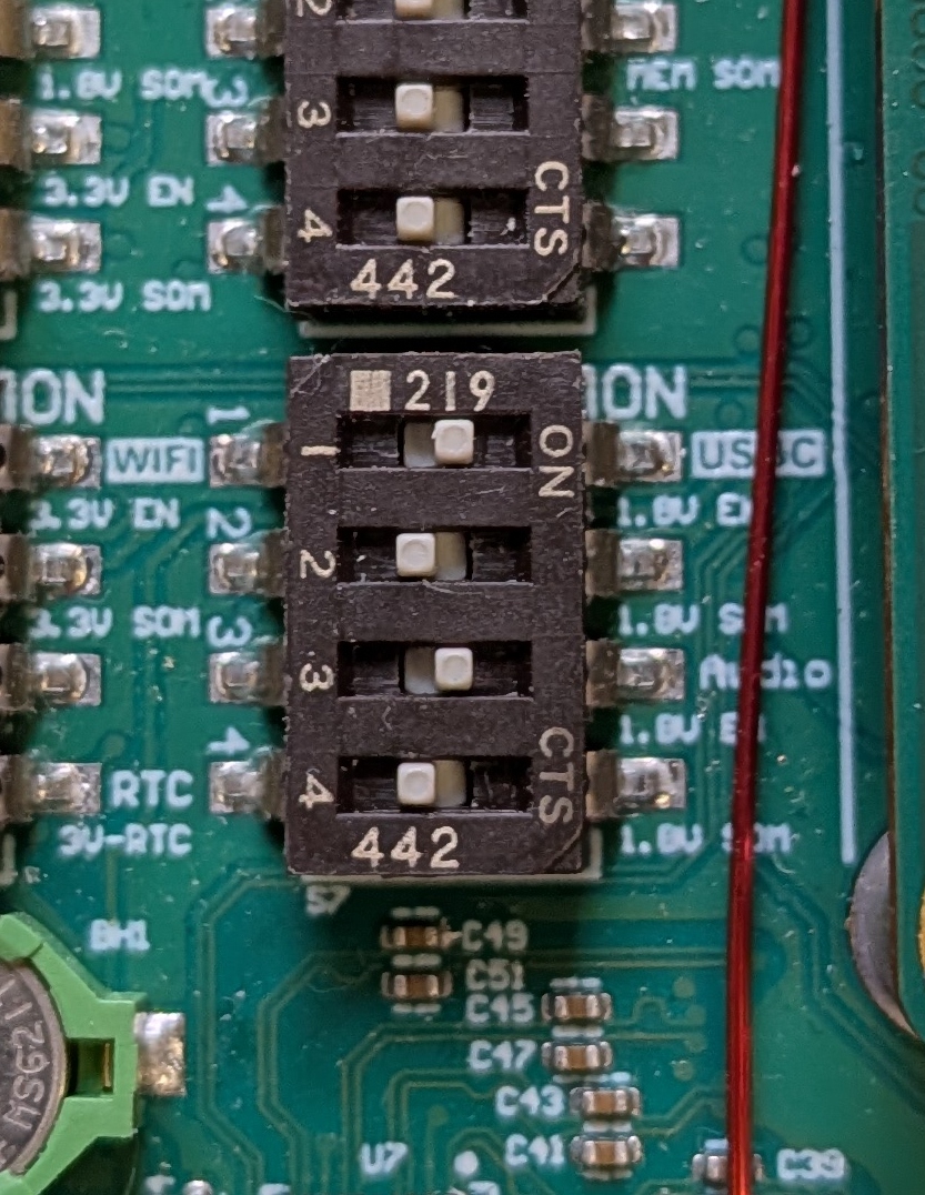

Ensure that Switch S7 is set properly.
  • Switch 1 should be set to enable the USBC, which is a top level enable to send 1.8 V for USB-C
  • Switch 2 can be either set or not set
    • If Switch 2 is not set the 1.8V comes from the DC supply on the Development Kit
    • If Switch 2 is set the 1.8V comes from the SOM
