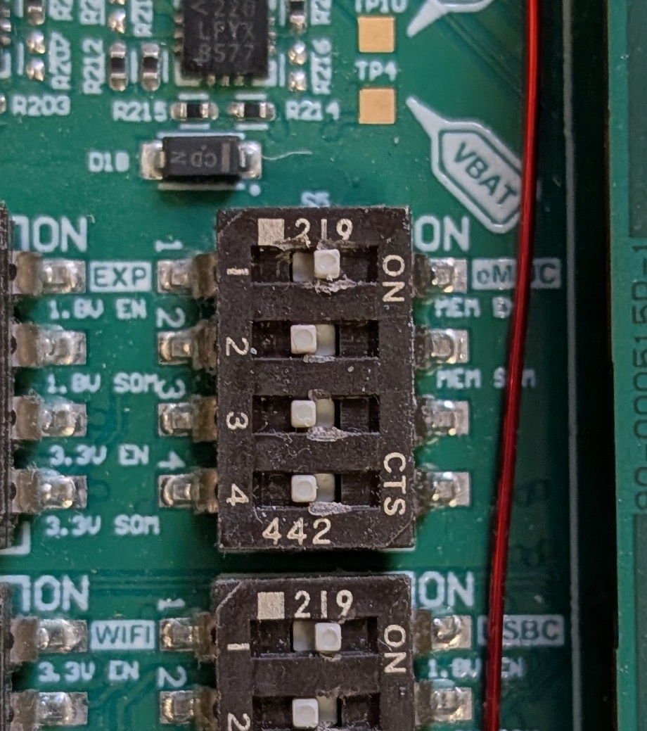

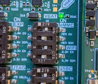

Ensure that Switch S5 is set properly.
  • Switch 1 should be set to enable the 1V8 MEM-EN from the DC supply
  • Switch 2 should not be set to disable 1V8 MEM-SOM from the SOM
