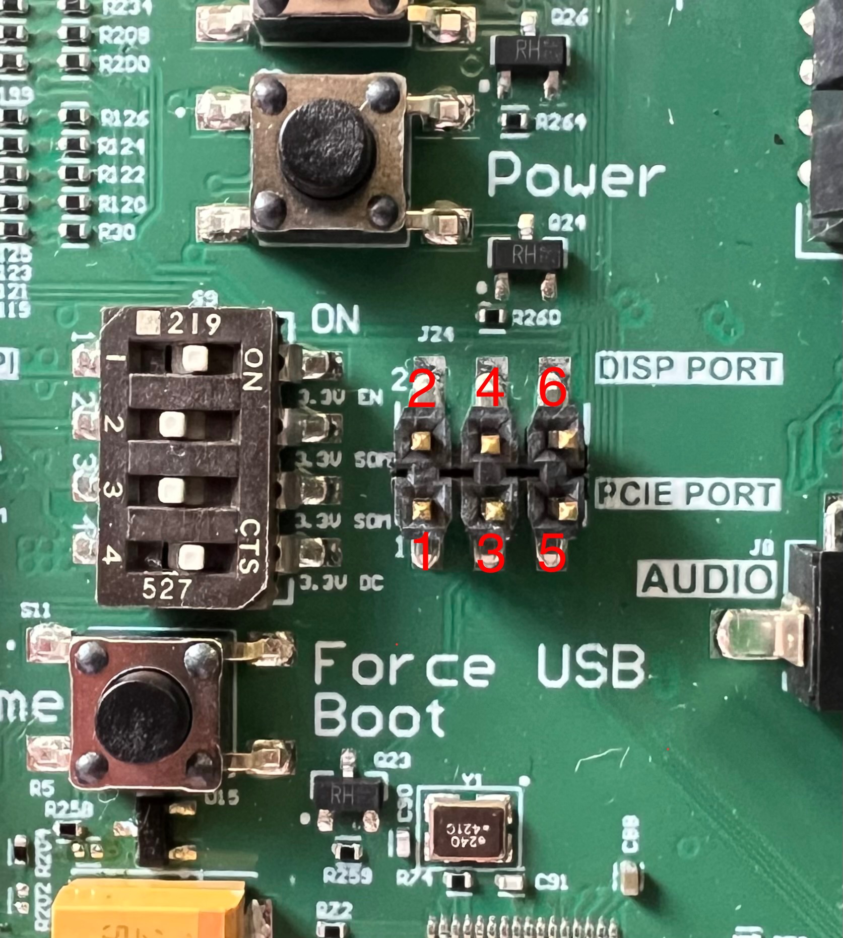

Remote button and power control is possible with the J24 header on Rev -3 and onward boards. The motivation behind this is to allow remote booting of the SOM for remote work/access. The J24 lines expect 1.8V-3.3V input voltage to trigger events. A breakdown of the J24 pins can be seen below:
  • Pin 1 - EXT-HOME - Logic high to "press home button" i.e. pull HOMEn low.
  • Pin 2 - EXT-RESIN - Logic high to "press reset button" i.e. pull RESINn low.
  • Pin 3 - EXT-BUSBn - Requires a hardware modification, R258 must be populated, so will be left out of below example. This results the SOM to FORCE USB BOOT unless EXT-BUSBn is logic high.
  • Pin 4 - EXT-VOL-UP - Logic high to "press volume up button" i.e. pull VOL-UPn low.
  • Pin 5 - EXT-POW-EN - Logic high to "set power switch to on" i.e. enable 12V-DC rail.
  • Pin 6 - EXT-POW-BTN - Logic high to "press power button" i.e. pull POW-BTNn low. Note this has to be for at least 400ms.

Pin Hardware Validated? Software Validated? Notes
Pin 1 - EXT-HOME (/) (/) Hardware: Meter on S12 and watch voltage toggle when Pi GPIO is toggled
Software: evtest /dev/input/event1 and watch for events on GPIO toggle to check in Linux
Pin 2 - EXT-RESIN (/) (/) Hardware: Meter on S4 and watch voltage toggle when Pi GPIO is toggled
Software: evtest /dev/input/event3 and watch for events on GPIO toggle to check in Linux
Pin 3 - EXT-BUSBn (/) (/) Mod the board to populate R258. Set EXT-BUSBn logic high and can boot the SOM to Linux as usual. With EXT-BUSBn held high, can still run gpiomon ForceUSBBoot and see physical button presses. Can also still see toggles from the GPIO and Pi.
Hardware: Meter on S11 and watch voltage toggle when Pi GPIO is toggled
Software: gpiomon ForceUSBBoot and watch for events on GPIO toggle to check in Linux
Pin 4 - EXT-VOL-UP (/) (/) Hardware: Meter on S3 and watch voltage toggle when Pi GPIO is toggled
Pin 5 - EXT-POW-EN (/) N/A Hardware: Set S13 to "OFF" and toggled EXT-POW-EN with Pi. Saw D29 turn on and was able to hold S2 (Power) and boot into Linux. Also watched VBAT go high with TP4 and a meter.
Pin 6 - EXT-POW-BTN (/) (/) Hardware: Meter on S2 and watch voltage toggle when Pi GPIO is toggled
Software: evtest /dev/input/event2 and watch for events on GPIO toggle to check in Linux
