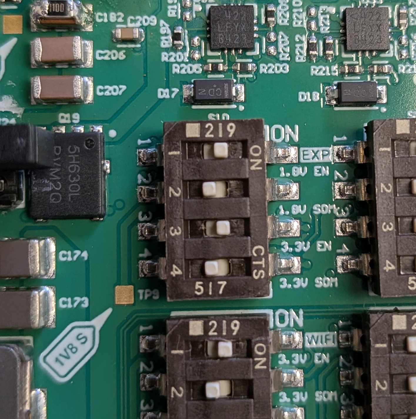

Ensure that Switch S10 is set properly.
  • Switch 1 should be set to enable the 1V8 expansion supply from the DC supply
  • Switch 2 should not be set to disable the 1V8 expansion supply from the SOM
  • Switch 3 should be set to enable the 3V3 expansion supply from the DC supply
  • Switch 4 should NOT be set for Rev 1 or 2 of the Development Board as 3.3V from the SOM may actually be a higher volage. See MitySOM-QC6490 Development Kit Datasheet for further details

Using the EXP power pins
The 1V8-EXP and 3V3-EXP pins provide power output on the expansion header. The power rail source can be configured to either come from the devkit baseboard power output (e.g. 1V8-DC), or the SOM power output (e.g. 1V8-SOM).
This is configurable by either hardware or software, with software control taking precedence. For more information on power output, reference the MitySOM-QC6490 Developmnet Kit Datasheet.
Hardware control example:
  1. Enable the 1V8-EXP power output by setting the DIP switch S10-1 to the ON position.
  2. Change the 1V8-EXP power source to 1V8-SOM by setting the DIP switch S10-2 to the ON position. (The 1V8-DC power source is selected by setting it to the OFF position).
Software control example:
  1. Enable the 1V8-EXP power output by setting the 1V8-EXP-EN GPIO pin to HIGH:
    gpioset -z 1V8-EXP-EN=1
  2. Change the 1V8-EXP power source to 1V8-SOM by setting the 1V8-EXP-SOM GPIO pin to HIGH:
    gpioset -z 1V8-EXP-SOM=1
    (The 1V8-DC power source is selected by setting it LOW).
