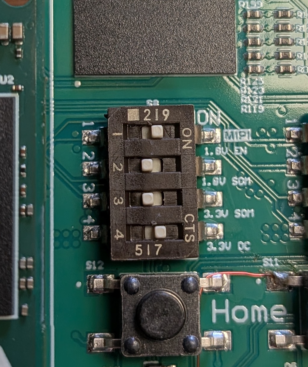

Ensure that Switch S8 is set properly.- Switch 1 should be set to enable MIPI, which is a top level enable for 1.8 V for the MIPI interface
- Switch 2 can be either set or not set
- If Switch 2 is not set the 1.8V comes from the DC supply on the Development Kit
- If Switch 2 is set the 1.8V comes from the SOM
- Switch 3 should NOT be set for Rev 1 or 2 of the Development Board as 3.3V from the SOM may actually be a higher volage. See MitySOM-QC6490 Development Kit Datasheet for further details
- For Rev 3 onward, Switch 3 can be either set or not set.
- If Switch 3 is not set the 3.3V comes from the DC supply on the Development Kit
- If Switch 3 is set the 3.3V comes from the SOM
- Switch 4 should be set to enable the 3V3 CSI from the DC supply

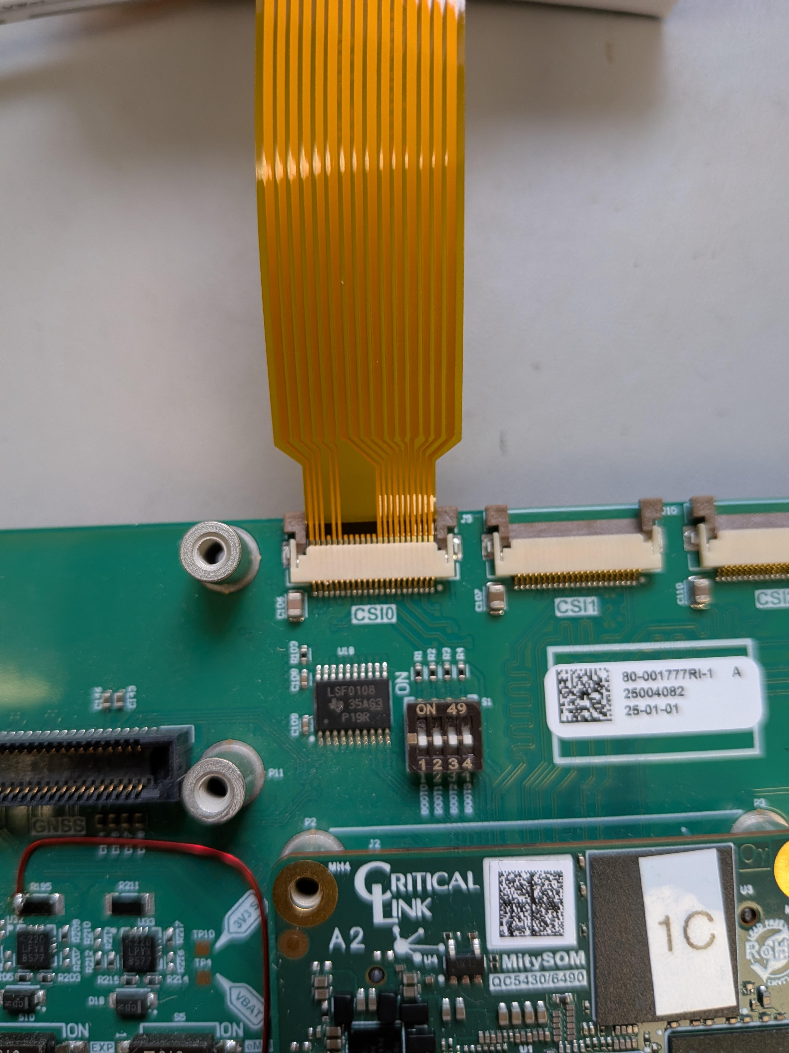

Note that the connector on the Development Board is a Hirose FH12A-22S-0.5SH(55) (22 pin 0.5 mm pitch).
Also note that when installing the cable the dark brown latch on the connector should be up and the cable should be inserted between the dark brown latch and light brown body with the pins on the cable facing up. Once the cable is in position the dark brown latch should be pushed down to secure the cable.
Please see the picture below for an example of a properly connected cable:
