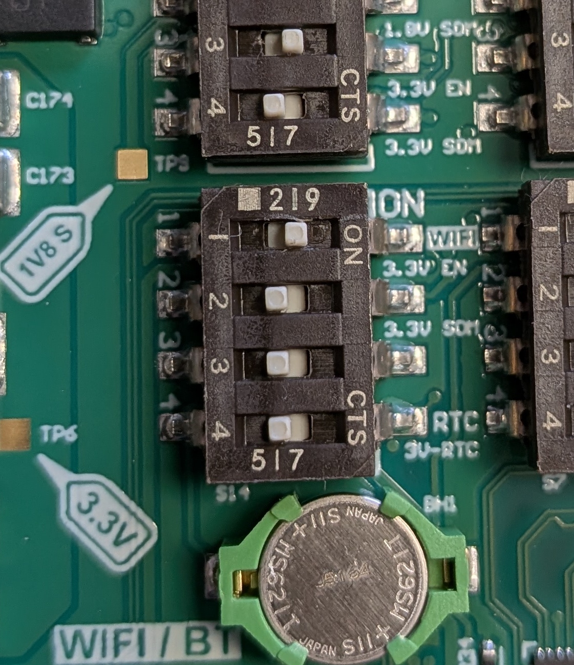

Ensure that Switch S14 is set properly.
  • Switch 1 should be set to enable the 3V3 WIFI from the DC supply
  • Switch 2 should NOT be set for Rev 1 or 2 of the Development Board as 3.3V from the SOM may actually be a higher volage. See MitySOM-QC6490 Development Kit Datasheet

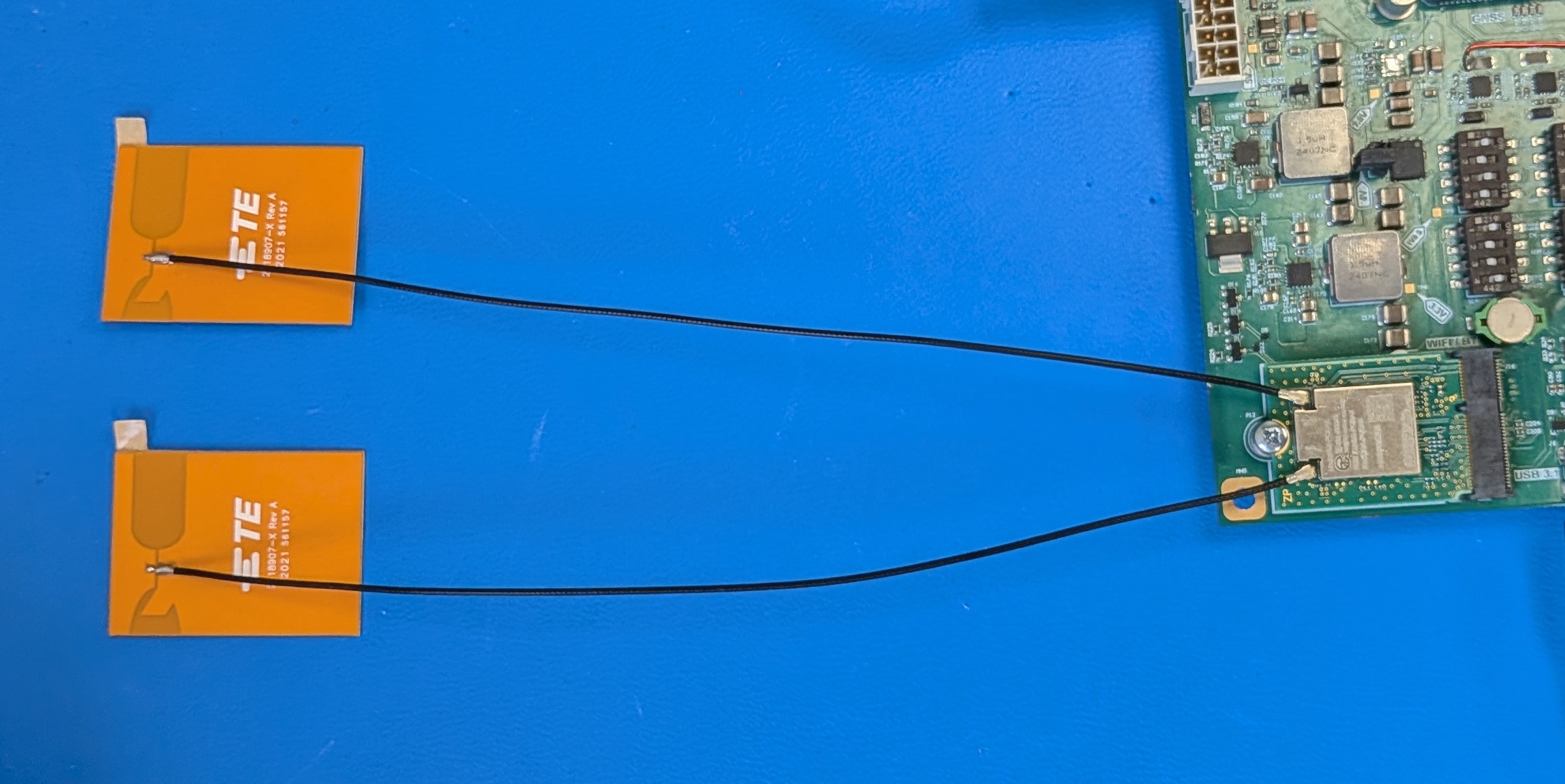

Using the Silex SX-PCEAX-M2 to connect to a Wi-Fi network
  1. If you do not already have a Silex SX-PCEAX-M2 one can be obtained here
  2. Make sure the antennas are connected to the SX-PCEAX
  3. Insert the radio module into J16
  4. If you have a Rev 1 Development Board, use an M2.5 screw to secure the module. If you have a Rev 2 Development Board, use an M2 screw to secure the module.
