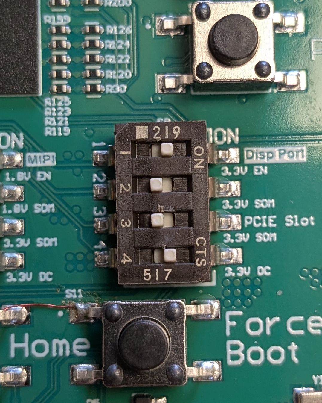

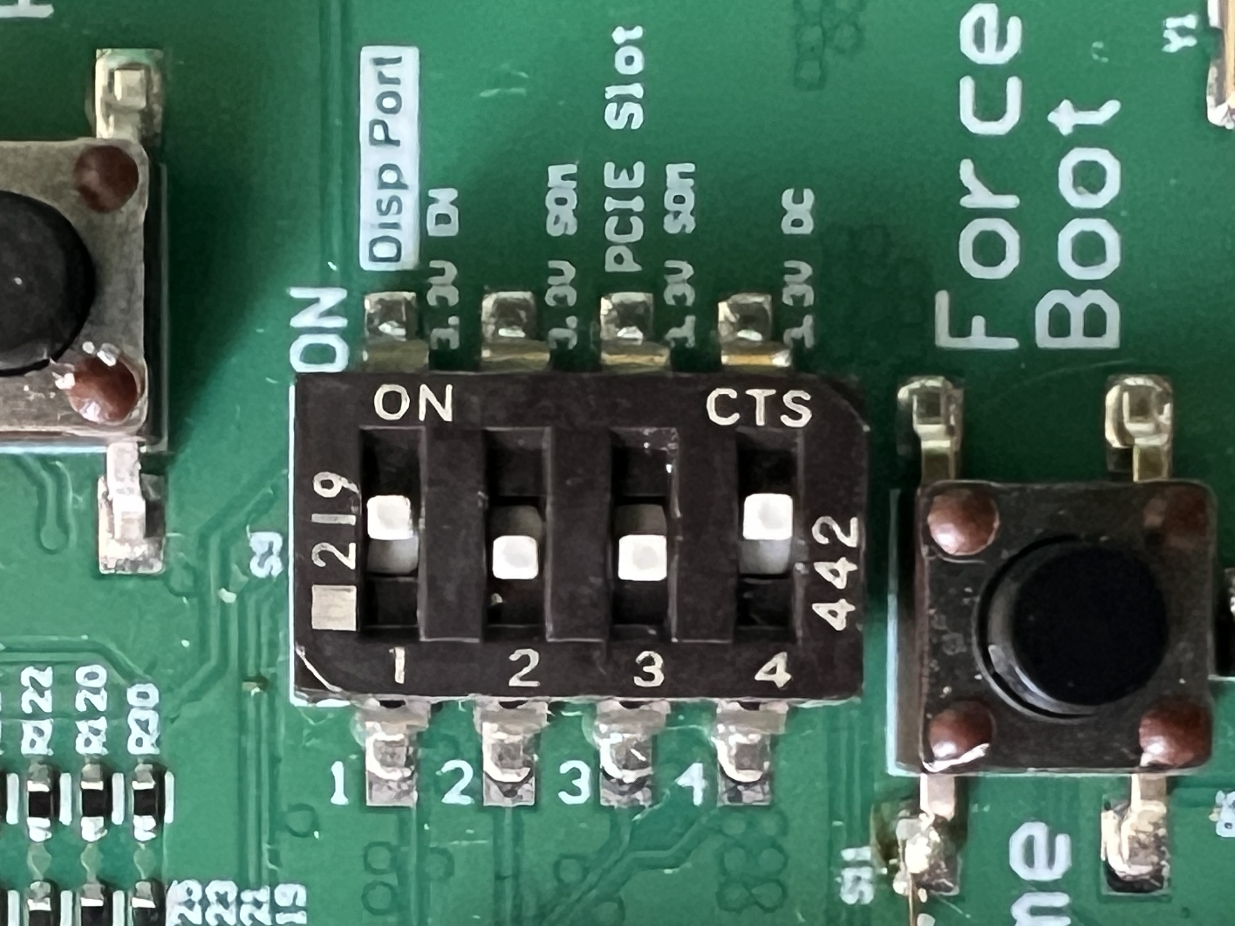

Ensure that Switch S9 is set properly:
  • Switch 3 should NOT be set for Rev 1 or 2 of the Development Board as 3.3V from the SOM may actually be a higher volage. See MitySOM-QC6490 Development Kit Datasheet for further details
    • For Rev 3 onward, Switch 3 can be either set or not set.
      • If Switch 3 is not set the 3.3V comes from the DC supply on the Development Kit
      • If Switch 3 is set the 3.3V comes from the SOM
  • Switch 4 should be set to enable the 3V3 PCIe from the DC supply
