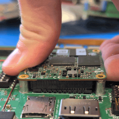

Handling the SOM
(!) Please take the following into account when handling the SOM (!)
  1. The MitySOM-QC has three wafer level packages (outlined in red in the image below). Please take care to not touch or apply pressure to these packages when handling the SOM.
  2. Note that when removing the MitySOM-QC6490 the SOM should be removed by lifting up the left or right side first, as shown below. The Samtec SEARAY™ connectors can be "zippered" during mating/unmating.

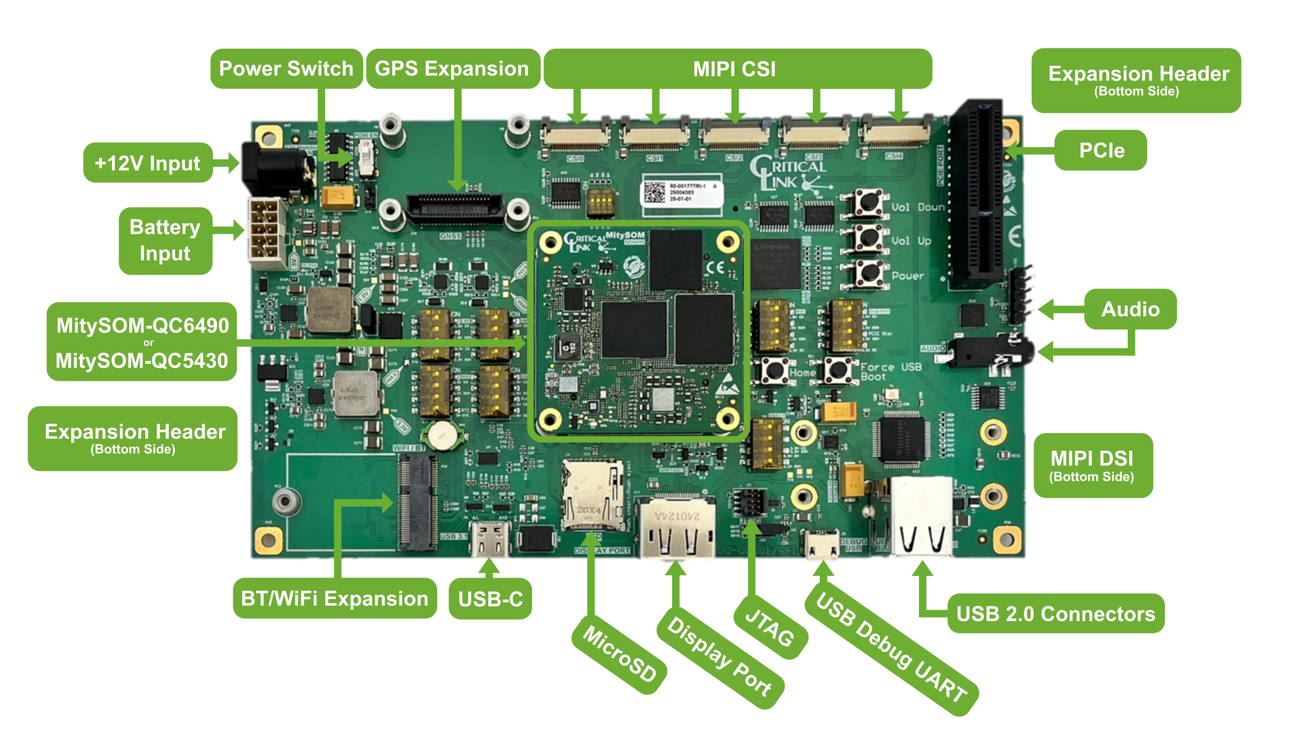

Setting up the Development Kit
  • Make sure Power Switch S13 is in the off position
  • Make sure the Boot Mode Switches (S1) are set properly
    • Currently all should be set to 0 as UFS is the only boot media supported at this time
  • Make sure the Power Control Switches (S5-S10, S14) are set appropriately
  • Connect the provided 12V Power Supply to barrel connector P1 on the top side of the development board
    • Note: The provided power supply can provide up to 36 W. This is adequate for powering the MitySOM-QC6490 and most interfaces on the development kit. However, if a power hungry device is added to the PCIe slot a larger power supply may be required.
  • Connect the development kit to a PC using provided USB micro cable to the USB Debug UART J5 on the top side of the development kit board
    • On your PC open your preferred application for communicating with the Debug UART (e.g. putty, minicom, Tera Term, screen) at a baud of 115200
