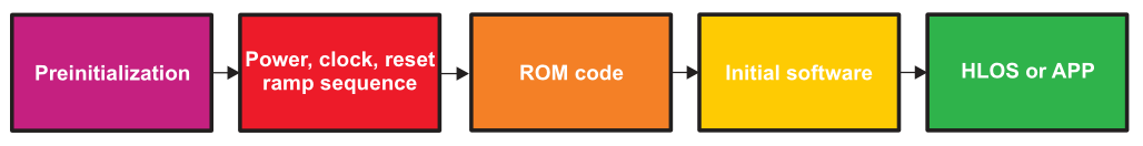

Chapter 5 of the AM62x TRM describes the boot process in detail.
In the diagram below, u-Boot is the "Initial Software"
The ROM code in the AM62x checks the boot mode pins at startup (or reset) and based on their configuration attempts to load the "Initial Software (u-Boot)" from the associated device.
The actual boot devices available will depend on the model of the MitySOM-AM62 in use. All models support booting from UART, MMCSD, and USB.
