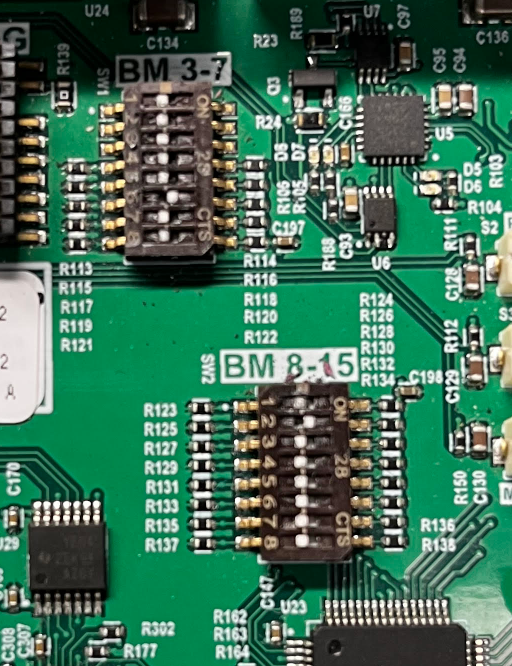

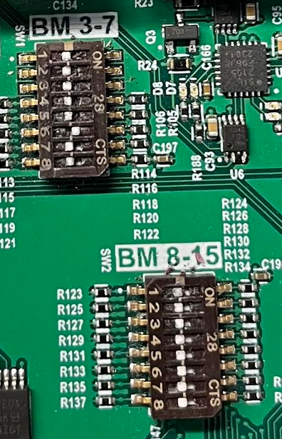

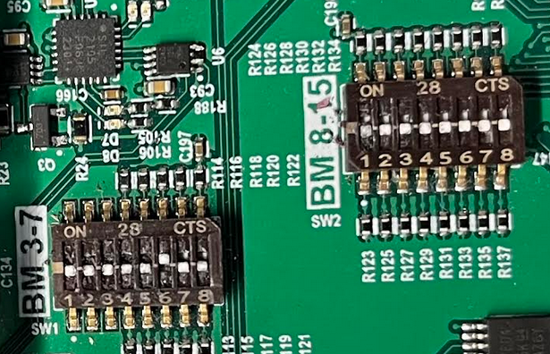

Boot Pin and Hardware Configuration¶
Boot Pin Layout| B3 | B4 | B5 | B6 | B7 | B8 | B9 | |
| 0 | 0 | 1 | 0 | Link Info (0) | 0 | Clkout Off (0) |
- Using the USB eth adapter and ethernet cable, connect the devkit ethernet port J4 to the host computer
