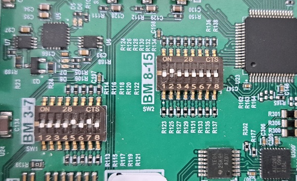

DFU or Device Firmware Upgrade is a method for transferring and flashing boot files over USB. The 62x/62a/62p can boot over DFU, transferring the necessary U-Boot files from a host computer to the device via a USB connection.
Reference: TRM Section 5.3 "Boot Mode Pins"
B3 B4 B5 B6 B7 B8 B9
0 1 0 1 No Swap (0) DFU (0) 0.85V CoreV (0)
Note: B9 may need to be changed depending on the Revision of the SOM. You can check TP9 immediately after power on to see which voltage B9 should be set to.

2. Setup the device
  1. Connect the device and host computer with a USB cable.
  2. Set the boot switches to DFU mode. Switches: SW1 = [00001010] SW2 = [01000000].
  3. Turn on the device.
