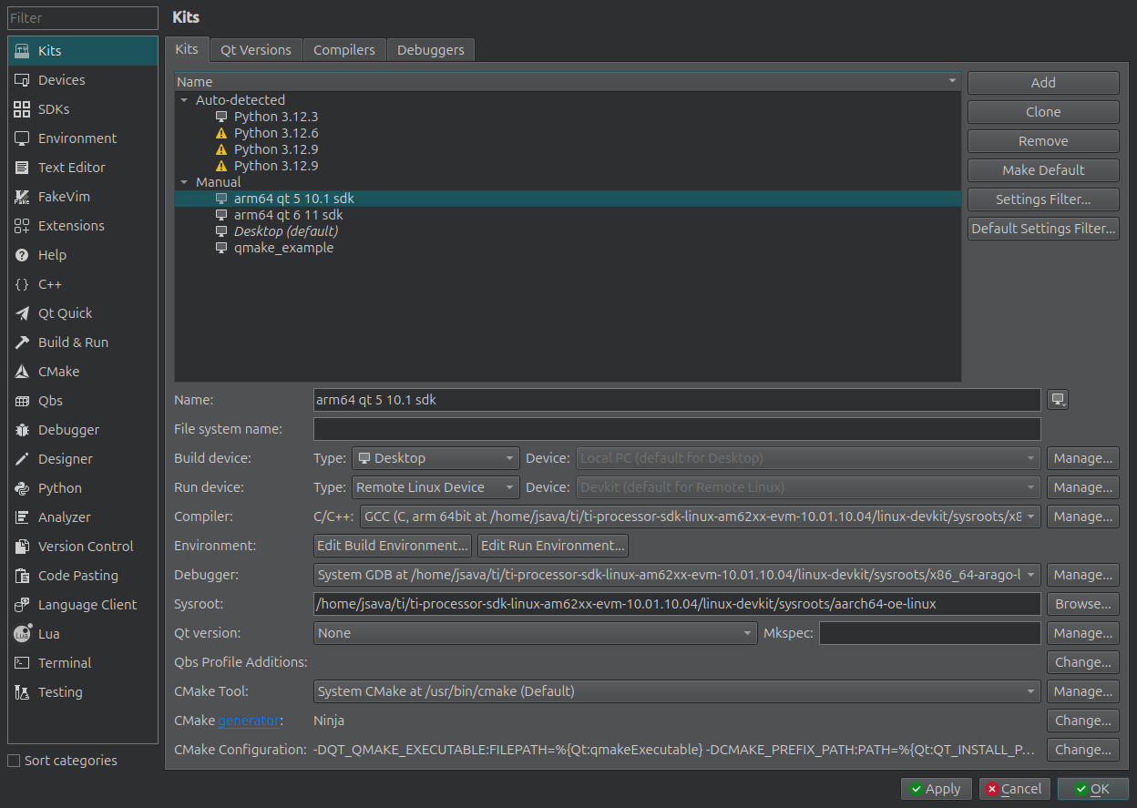

Create a kit SDK 10.01
  • Navigate to toolbar: Edit->Preferences
    • Select the "Kits" category
      • On the Kits tab hit "Add"
      • Name: "arm64 qt 5 10.1 sdk"
      • Build device: Type: "Desktop"
      • Run device: Type: "Remote Linux Device"
      • Compiler: C/C++: GCC (C, arm 64bit at /<SDK_INSTALL_DIR>/ti-processor-sdk-linux-am62xx-evm-10.01.10.04/linux-devkit/sysroots/x86_64-arago-linux/usr/bin/aarch64-oe-linux/aarch64-oe-linux-gcc)
      • Debugger: System GDB at /<SDK_INSTALL_DIR>/ti-processor-sdk-linux-am62xx-evm-10.01.10.04/linux-devkit/sysroots/x86_64-arago-linux/usr/bin/aarch64-oe-linux/aarch64-oe-linux-gdb
      • Sysroot: /<SDK_INSTALL_DIR>/ti-processor-sdk-linux-am62xx-evm-10.01.10.04/linux-devkit/sysroots/aarch64-oe-linux
      • Qt version: "None"
      • CMake Tool" "System CMake at /usr/bin/cmake (Default)
      • CMake Configuration select "Change" and add the following lines
        -DOE_QMAKE_PATH_EXTERNAL_HOST_BINS:STRING=%{Env:OE_QMAKE_PATH_HOST_BINS}
        -DCMAKE_NO_SYSTEM_FROM_IMPORTED:UNINITIALIZED=1
  • Click "Apply" then "Ok"

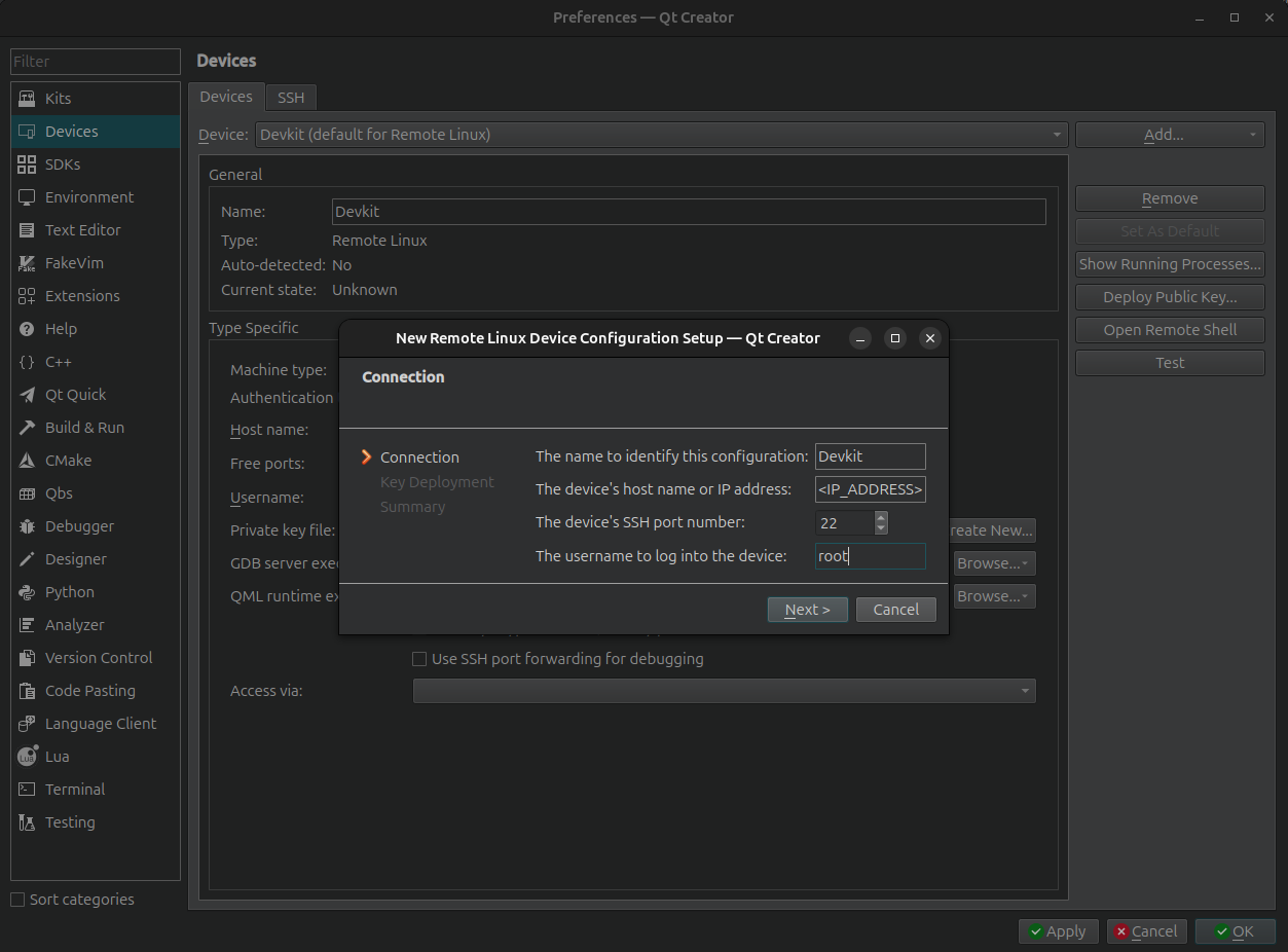

Add the device
    • Select the "Device" category
      • In the "Devices" tab select Add->Remote Linux Device->Start Wizard
        • The name to identify this configuration: "Devkit"
        • The device's host name or IP address: <DEVKIT_IP_ADDRESS>
        • The username to log into the device: "root"
      • Hit "Next" until it prompts to "Finish" the creating the device
      • Device test should finish successfully

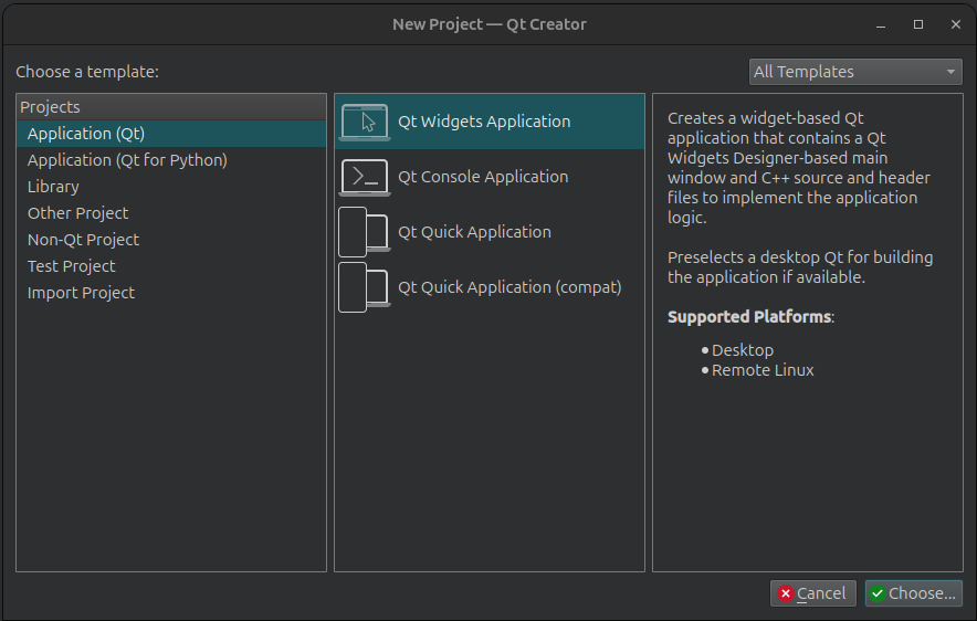

Create a Qt Widget Project
  • Navigate to toolbar: File->New Project
    • The following window should appear. Select "Qt Widgets Application"
    • Name: "hello_world_gui"
    • Next
    • Build System: "CMake"
    • Select "Next" until it prompts to "Finish" the project

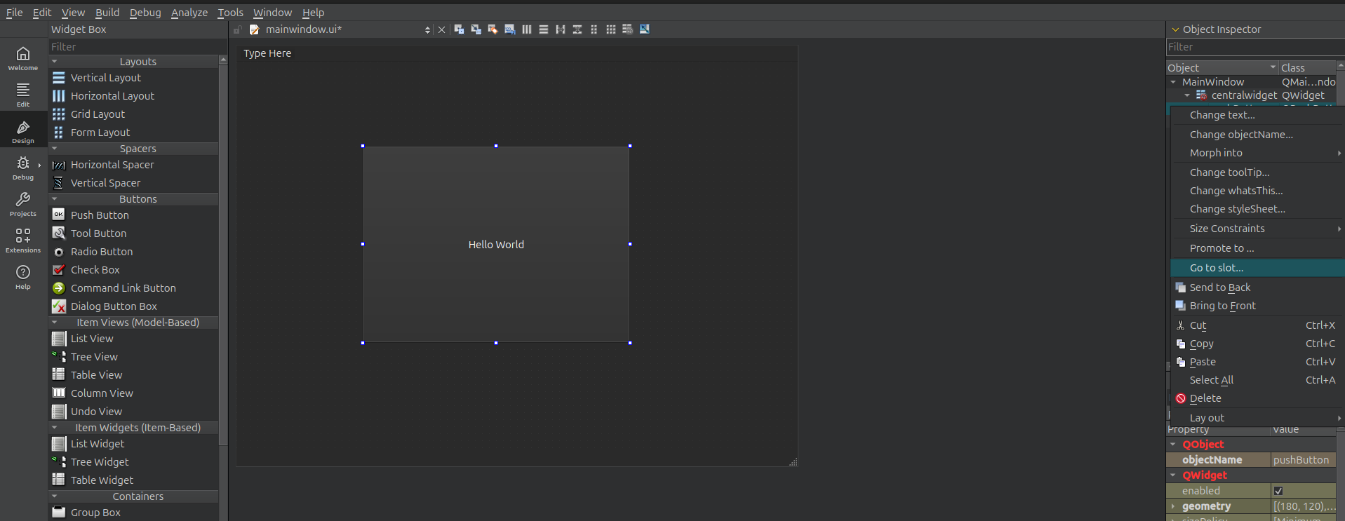

Update UI Window
  • Navigate to the newly created project
    • Select hello_world_gui->hello_world_gui->Froms->mainwindow.ui
    • The "Design" Tab should now be open
      • Drag and drop a "Push Button" into the window
      • Navigate to "Object Inspector" on the right hand side of the screen
        • right click on "pushButton" and select "go to slots"
          • Hit "ok" in the pop up window

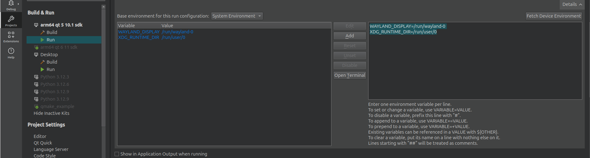

Add Environment Variables
  • Qt Creator needs to know the following Environmental variables in order to launch on the Devkit
  • In the toolbar on the left hand side of the screen select "Project"
  • SDK 10.01
    • Under "Build and Run" select arm64 qt 5 10.1 sdk->Run
      • In "Run Settings" find "Environment"
        • Select Details and add the following
          WAYLAND_DISPLAY=/run/wayland-0
          XDG_RUNTIME_DIR=/run/user/0
  • SDK 11
    • Under "Build and Run" select arm64 qt 6 11 sdk->Run
          LANG=C.UTF-8
          LC_ALL=C.UTF-8
          QT_QPA_PLATFORM=linuxfb
SDK 10.01 example environment variables:

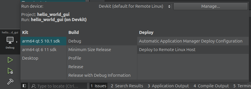

Launch the project on the Devkit
  • In the toolbar on the left hand side of the screen navigate to the monitor icon with "Debug" below it
    • Double check that the correct kit is selected
  • Select the green launch icon below the monitor icon
