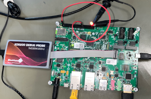

Complete Setup (Oscilloscope is out of picture)

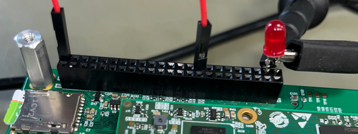

GPIO Expansion Close Up
Insert the long wire of the LED into pin 3 and the shorter GND wire into pin 1.
For this example, we will be using a wire instead of a button. Insert one end of the wire into pin 17 and the other end into pin 45.
WARNING: Do not insert either end of the male-to-male header wire into pin 46, as it is a 12V supply and could damage the GPIO pin—or worse, the chip.
