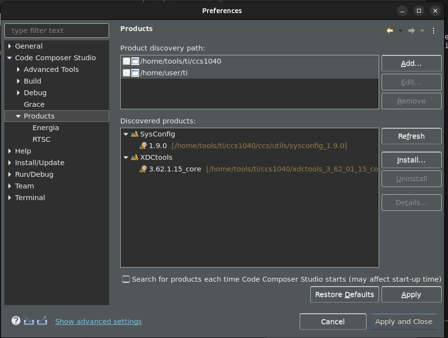

In code composure studio select Window->Preferences from the menu bar.
In the Preference dialog, select Code Composure Studio -> Products, and in the Product Discovery Path, add the following path:
/home/tools/ti/ti-processor-sdk-rtos-am57xx-evm-06.03.00.104-Linux-x86
then hit Apply and Close.

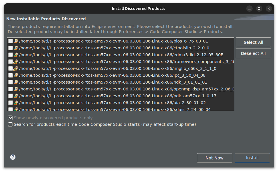

Shortly, you should see a pop-up with the following dialog. Click "select all" and then "Install".
Do not select "Restart". Instead, click "restart-later" and exit code composer normally and relaunch from the command-line.
