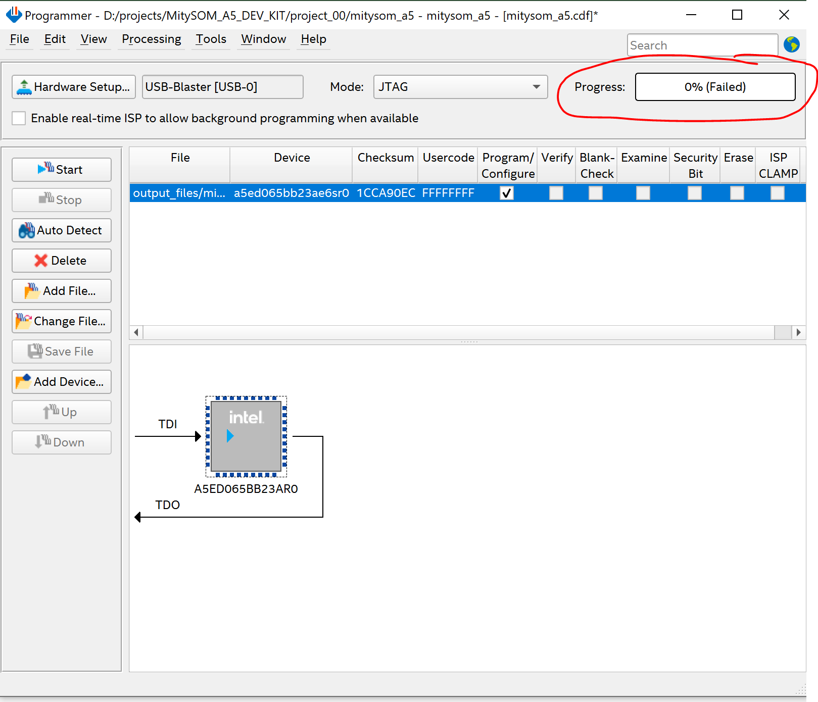

When I compiled the project, trying to program it, it just fails and there is no error message:
Probably something wrong in QSF file

RE: Fail to program device - Added by Mike Fiorenza 4 days ago
Maxim,
Please use the instructions found here for programming the QSPI NOR Flash (from the command line): https://support.criticallink.com/redmine/projects/mitysom_a5/wiki/Building_fpga_242pro
I have not found a way to get the Programming GUI to work with the Agilex 5 part yet since this device uses an SDM and separates the devices into two separate targets (ARM vs FPGA). This is also how Altera documents programming the flash on their development kit.

Also, I'm not sure about your comment regarding Programming GUI. Do you mean, that the programming can be done only by the command: quartus_pgm -m jtag -o "piv;output_files/a5e.hps.jic@2"
Correct, I am unaware of a solution to program the JIC/SOF via the Programming GUI only via command line.
You can also directly program the FPGA via the SOF instead of the JIC. It would still use the same command: quartus_pgm -m jtag -o "p;output_files/a5e.sof@2"
But the SOF needs to be programmed every power cycle and isn't persistent like flashing the JIC into flash.

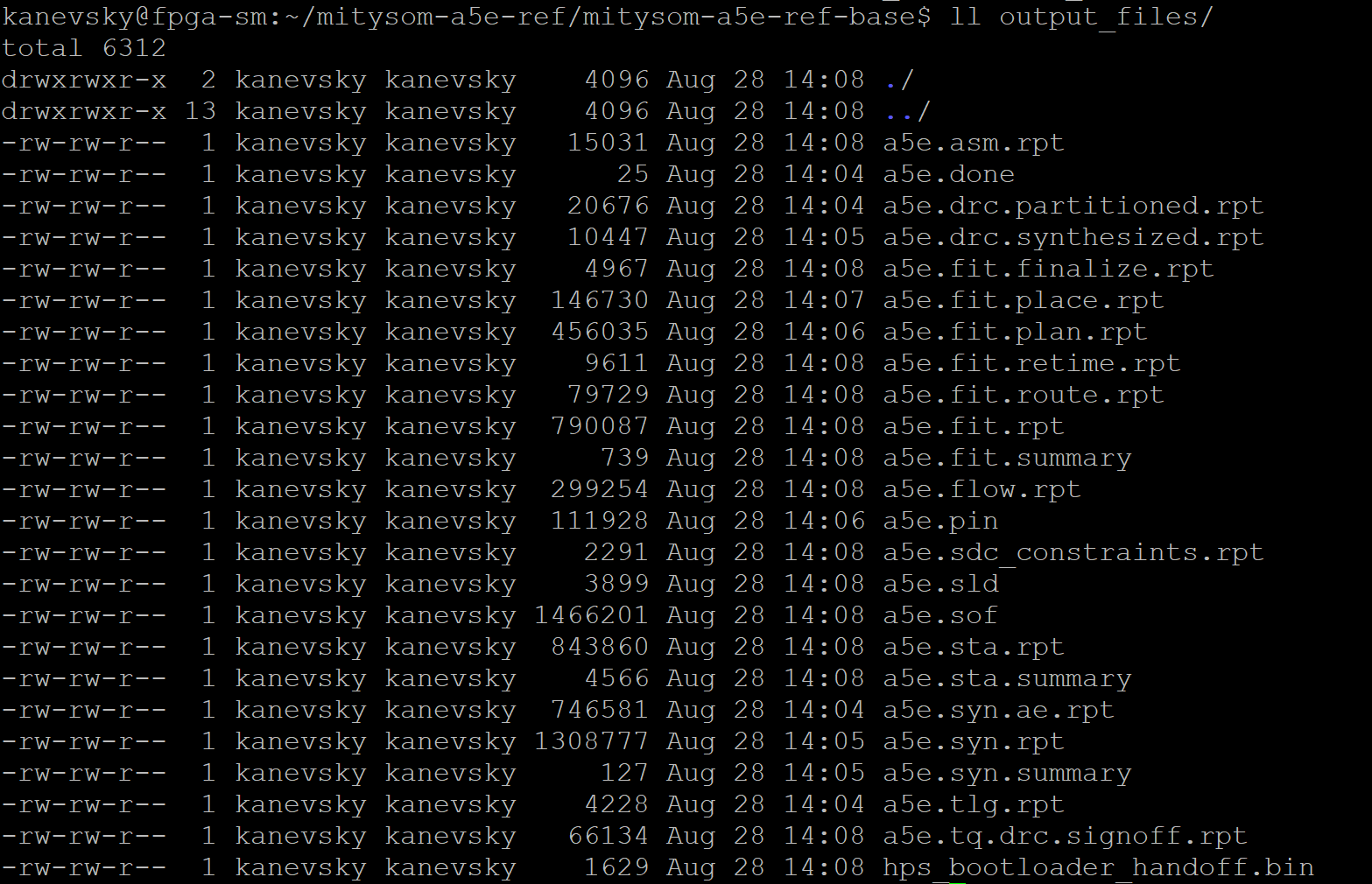

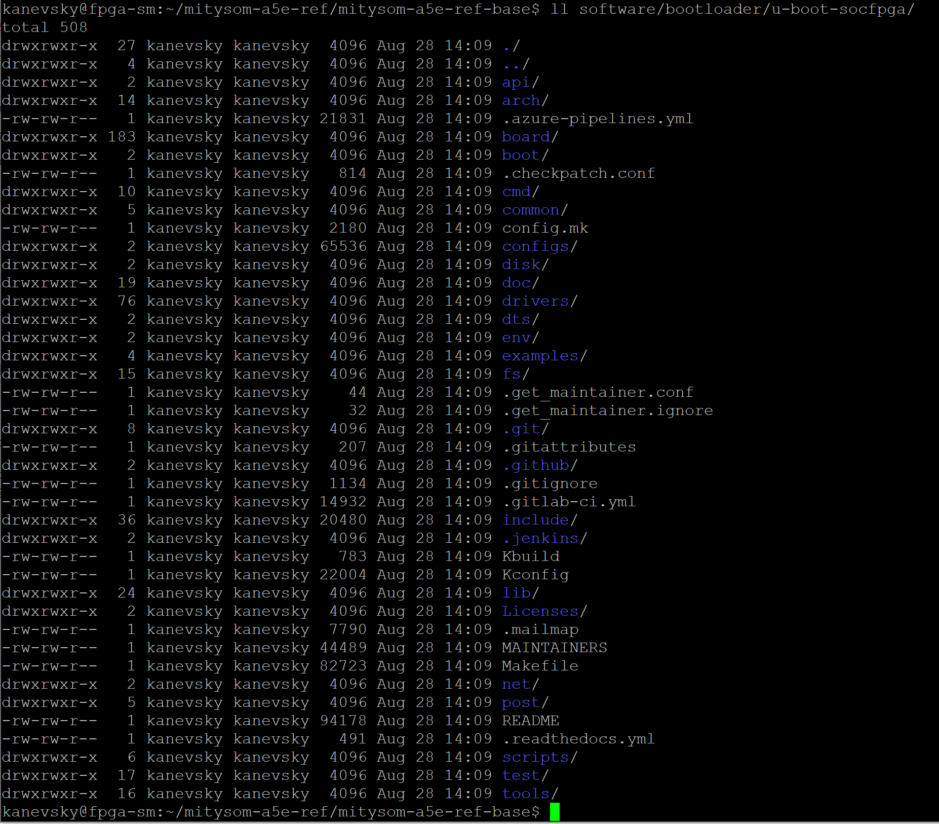

I've followed the instructions that you send me yesterday. The command "make jic" compiled the design.
I see directory software and under the path that specified in instructions, also in the folder output_files, no specified files:
output_files/a5e.hps.jic - The JIC file contains the preloader which is programming into the QSPI NOR.
output_files/a5e.core.rbf - The RBF file is the FPGA design, this belongs in /lib/firmware of the filesystem
software/bootloader/u-boot-socfpga/u-boot.itb - The bootloader file, this belongs in the FAT partition
But, the compilation passed successfully. What's wrong???
I followed the instructions as described. Run with Q24.2.0

No I didn't made any changes. I removed everything. I clone again, navigate to directory and run command "make jic". It run again and again no files as expected
RE: Fail to program device - Added by Maxim Kanevsky 2 days ago
Mike, please see attached log of the compilation
