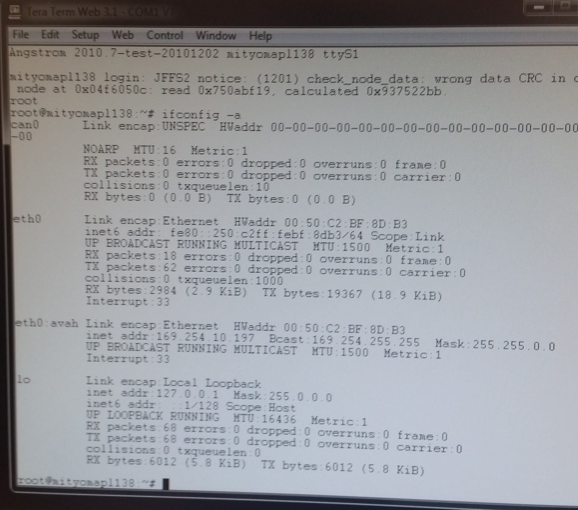

I have written the ifconfig -a command in U-Boot prompt and this was the output: {Attached 2 ifconfig.jpg} Is this the expected output?

I have written the
ifconfig -acommand in U-Boot prompt and this was the output: {Attached 2 ifconfig.jpg} Is this the expected output?
The command shows that no ip address has been assigned. Is the devkit connected to a network with a dhcp server? Do you have a link light?
Note: The RX packets: 18 and TX packets: 62 indicates the devkit is receiving networking packets. So the interface is working and receiving data.
