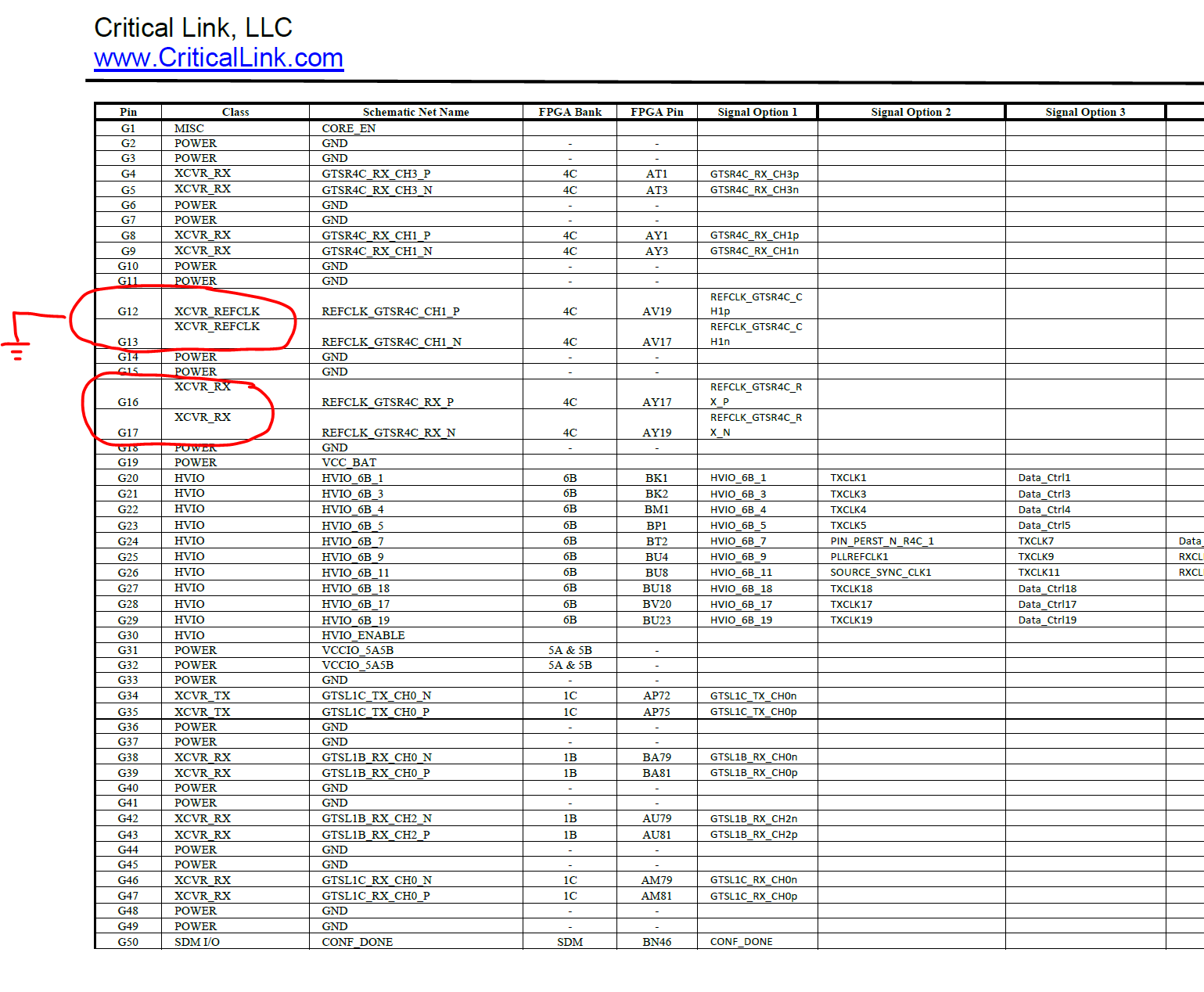

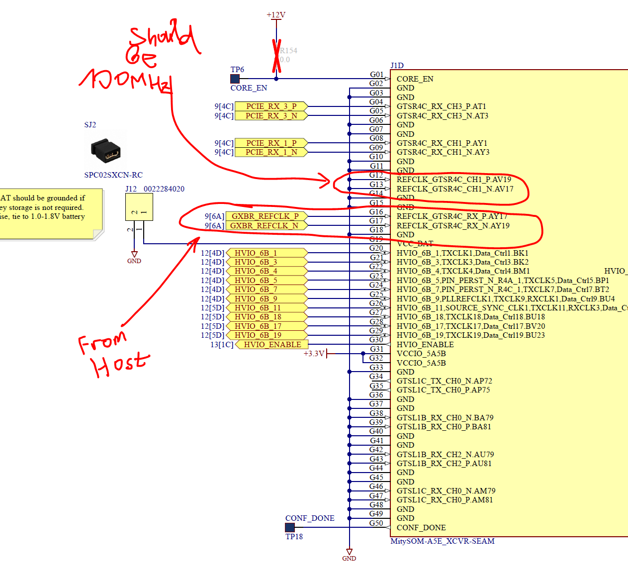

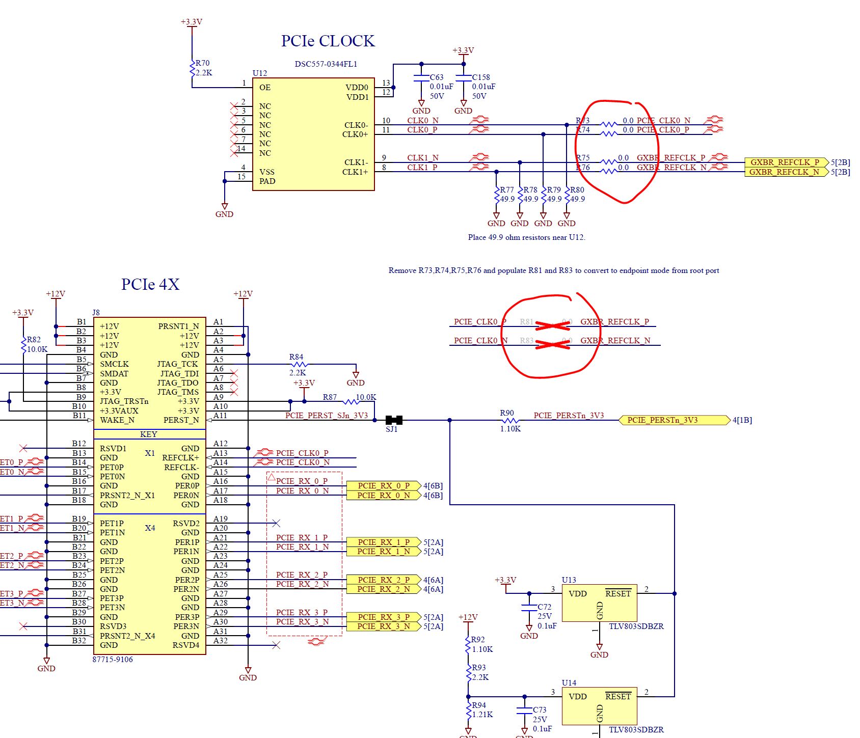

Me and Keith, we are working together. We've ordered a cable (PCIe edge on both ends and cross-connect - to make it possible to connect the Mity Carrier board as PCIe End-Point)
I saw also a kind of problem with clocks:
- there is an option to drive Reference Clock from Host, by removing resistors R73, R74, R75, R76 and assembling 0ohm on R81, R83
- but it supposed to be additional Reference clock that on Altera Dev. Board connected to 100MHz Clock Generator and on your carrier board these pins connected to ground
Do you think we will be able to operate such a way with only single Reference clock?? I know this question better to ask Altera, but what was your plan?? It was a reason, I suppose, why another reference clock on the connector was connected to ground.
MW RE: What is the recommended version of Quartus for MitySOM_A5? - Added by Michael Williamson about 1 year ago
Hello Maxim,
You only need 1 100 MHz reference clock to run the PCIe transceiver blocks. You should be able to use either pair (G16/G17 or G12/G13), just make sure you specify the correct pins in the quartus project. Our design requires using G16/G17, which should work for what you are trying to do.
-Mike
