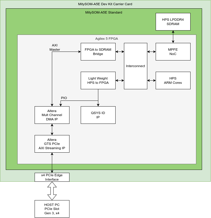

A block diagram of the example is shown below.
This demonstration does not include support for SDRAM cache coherency management between the Agilex-5 ARM complex and the SDRAM memory. The Agilex-5 ARM accesses the memory using non-cache modes.
The FPGA project utilizes the "Multi-Channel DMA IP for PCIe block" to facilitate transfers from the GTS PCIe EP Streaming IP to the FPGA2SDRAM AXI bridge.

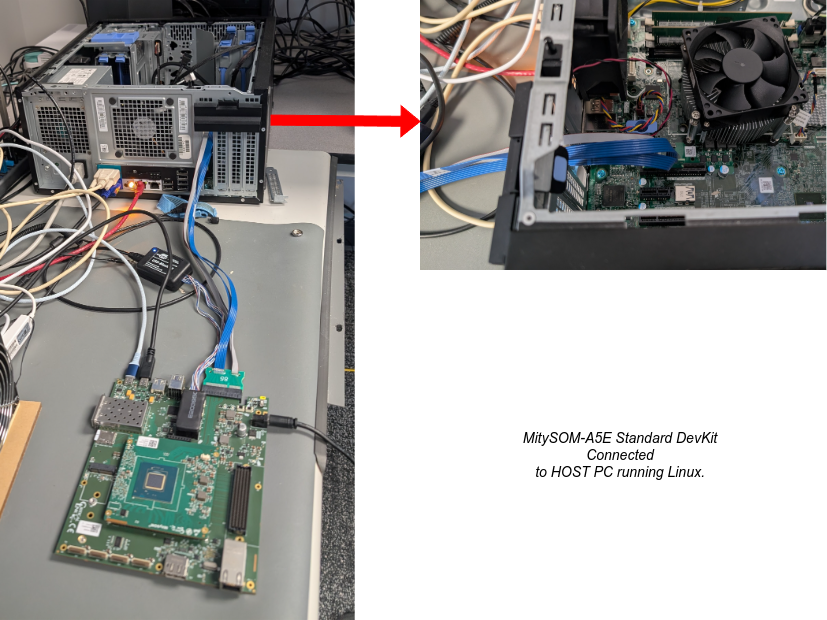

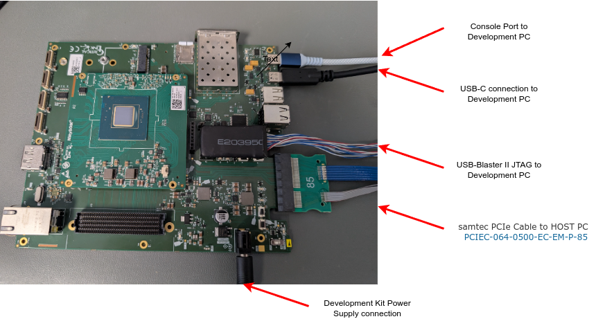

Connecting the Target to the HOST PC
With both the Target MitySOM-A5E development kit and the test HOST PC turned off, assemble the connected system according to the figures below.
