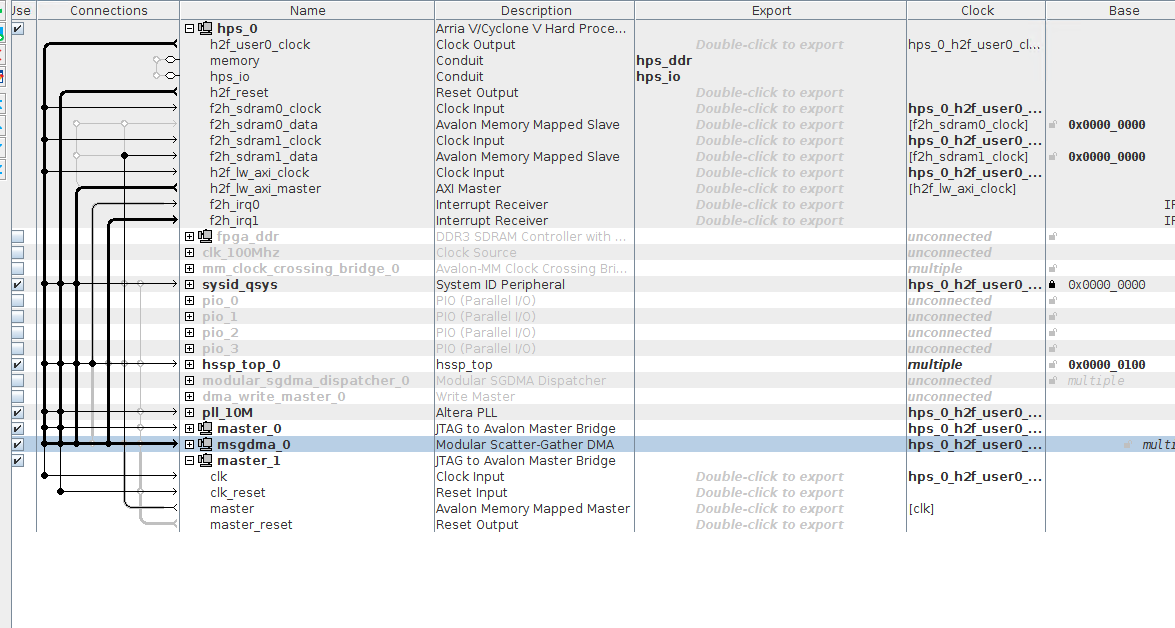

Hi,
Using MitySOM_5CSX, I added FPGA to HPS SDRAM interface avalon-mm read-only, and try to using jtag_avalon_master to read out the data from HPS DDR, but always timeout. Need a bridge or something worng?
BR,
Xiang
| clipboard-202602021625-of8oh.png (103 KB) clipboard-202602021625-of8oh.png | Qsys connection |

DV RE: JTAG_avalon_master access HPS DDR timeout - Added by Daniel Vincelette 6 months ago
Hi Xiang,
When you enabled the FPGA to HPS SDRAM bridge did you also rebuild your preloader and u-boot? This is needed because the HPS is the one that takes these bridges out of reset.
Best regards,
Dan

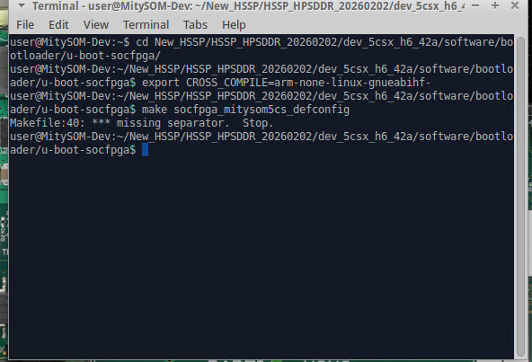

XS RE: JTAG_avalon_master access HPS DDR timeout - Added by Xiang Shuai 5 months ago
Hi Dan,
I meet an issue at step 4 configure and build U-boot and the SPL.
$ make socfpga_nitysom5cs_defconfig
Makefile:40: *** missing separator. Stop
what can I do?
BR,
Xiang
DV RE: JTAG_avalon_master access HPS DDR timeout - Added by Daniel Vincelette 5 months ago
Hi Xiang,
It looks like you have spelling mistake in your command, it should be the following:
make socfpga_mitysom5cs_defconfig
Best regards,
Dan
Hi Dan,
please see attached picture, that's a typo when I fill this page.
BR,
Xiang
Hi Xiang,
Sorry about the delay. It looks like this is either due to a missing or unexpected character in the U-Boot Makefile (around line 40), or it could be related to your build environment: it looks like you're using our Ubuntu 14.04 VM, which may be too old to build the newer example projects.
Can you please post your Makefile? Also, which branch of our Quartus reference design are you trying to use?
- 23.1-stable
- 18.1-stable
From your screenshot it appears you're using the Ubuntu 14.04 VM, which may have issues building these newer projects. We recommend the following Ubuntu versions:
- 23.1-stable: Ubuntu 22.04 LTS (this wiki page lists the required packages: https://support.criticallink.com/redmine/projects/mityarm-5cs/wiki/Building_uboot_231#Linux-Packages)
- 18.1-stable: Ubuntu 18.04 (the package list from the above wiki should also work)
Best regards,
Dan
