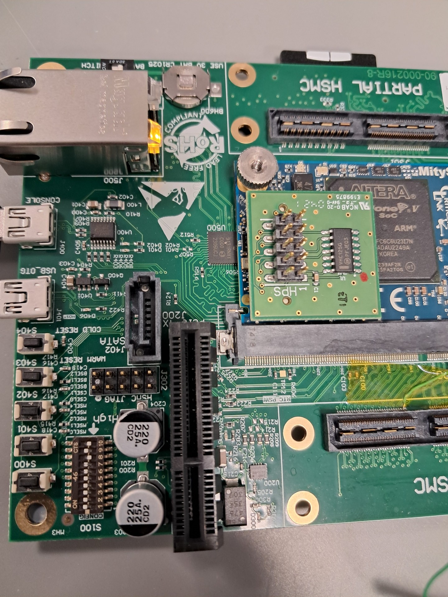

Boot configuration DIP switches set as in the attached photo (SD/MMC boot).

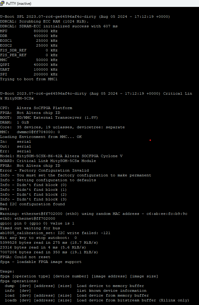

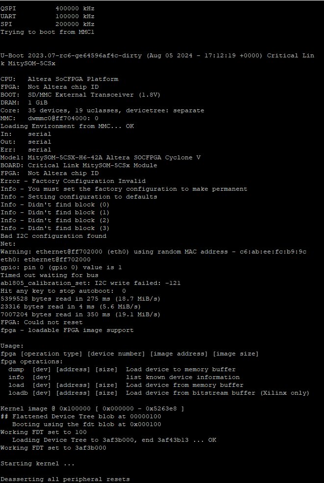

Board #2 consistently halts after “Starting kernel … / Deasserting all peripheral resets.”
The same SD card that boots on Board #1 fails on Board #2 with identical symptoms.
Serial log shows I²C/RTC messages (AB1805 write failed), “Factory configuration invalid,” and “FPGA: Could not reset,” before handing off to the kernel. I’ve attached screenshots of the full console output.

There appears like there are multiple issues going on from your boot log. The I2C bus is unhappy as well as the FPGA is failing to load. My guess is since the FPGA doesn't load it is causing the Kernel to hang on start-up.

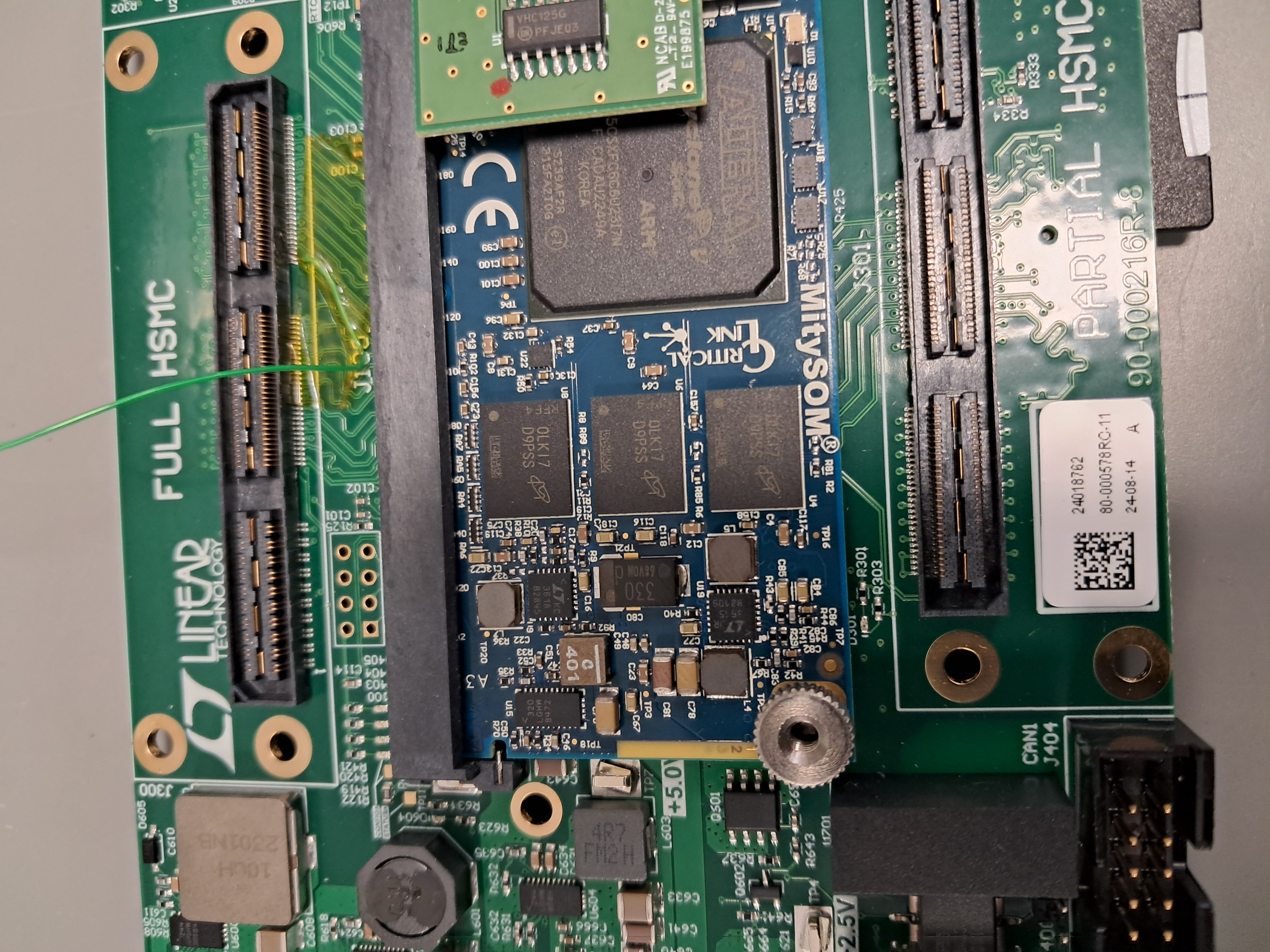

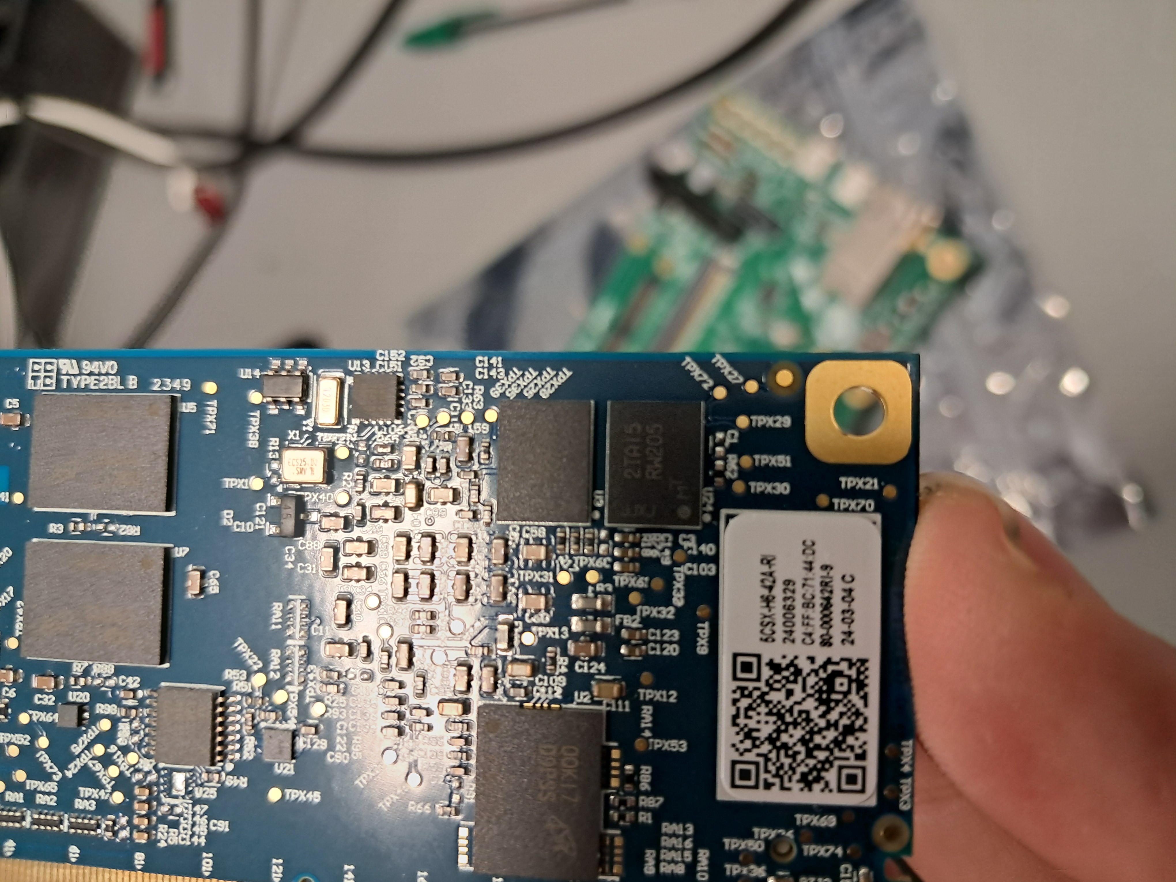

I’ve attached the serial numbers for both the SOM and the development kit.

It sounds like based on your findings the SOM module is the issue. It looks like you may have tried to reply to this post via email, which I do not think works for attachments. Can you either reply again and type the serial numbers as text or attach your files directly to the forum post.
There isn't necessarily a reset procedure for the SOM, as nothing is actually stored on the SOM itself (with the exception of the EEPROM which stores the serial / module number information). But your I2C bus to that EEPROM doesn't appear to be working anyways. I will follow up with you on steps for RMA after I've received the serial number for the module.
