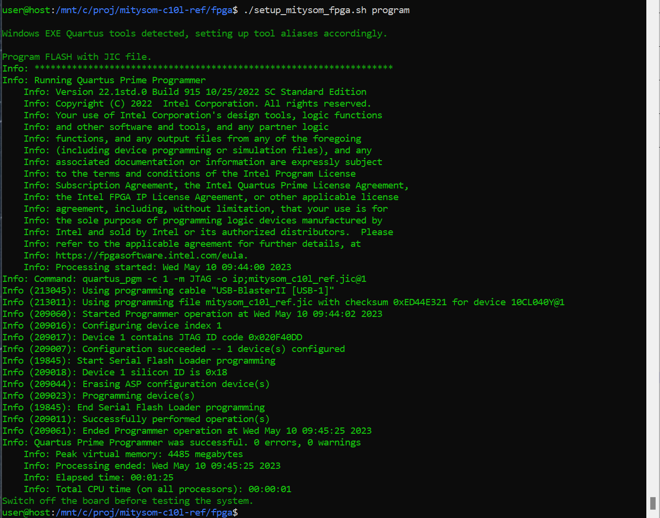

Programming the SOM¶
After the Makefile finishes building the reference design FPGA HW, compiles the application SW and creates the FLASH Programming File (.JIC), you can program the SOM's FLASH with either the Quartus GUI tools or by running the command make program.
Note that this will erase and overwrite the Factory Default FPGA configuration in the SOM's FLASH. Ensure that power is on and that the USB Blaster JTAG programmer is properly connected to the Development Kit in J2 before proceeding. Upon successful FLASH programming, you should see:
After successful programming, you should either power-cycle the Development Kit using slider switch S6 or force a reconfiguration of the FPGA from FLASH by depressing the nCONFIG pushbutton switch S1.
If the FLASH programming is unsuccessful, please:- Check power and USB Blaster connections to the board (for reference, see MitySOM-C10L Development Kit Architecture),
- Ensure that the JIC file was created without error, or
- Contact Critical Link for additional assistance.

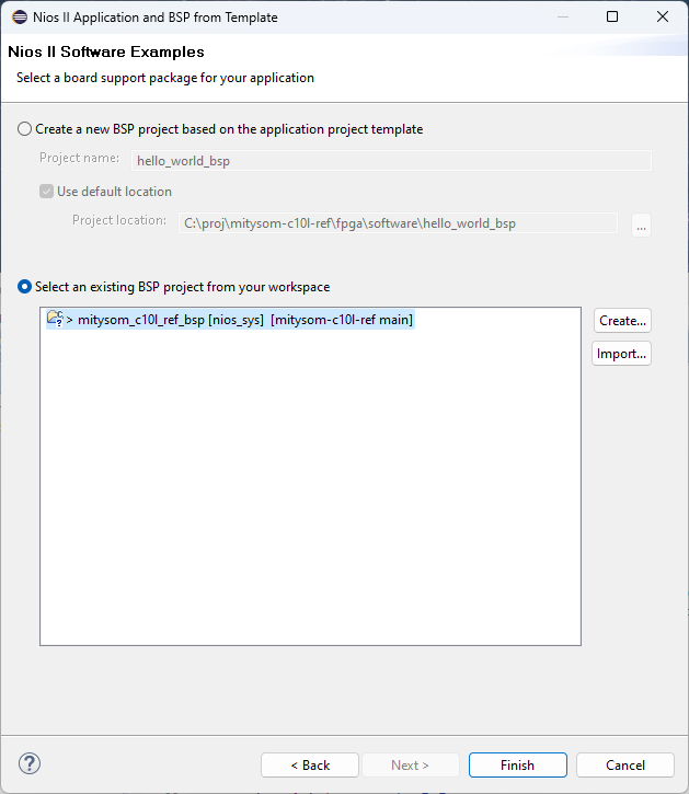

The software Board Support Package (BSP) and application is created and compiled by the Makefile if you have enabled compilation of the FPGA HW and generation of the SW and FLASH programming files. The setup process performs the necessary steps to compile the application using the command-line build tools. However, it does not automatically generate an Eclipse workspace and C Projects for the BSP and application for use with the Nios Software Build Tools GUI (Eclipse-based) which was installed when you installed the Intel Quartus Prime software along with the other steps listed above in the prerequisites.

Steps to Import BSP and Application
Steps to Create Custom Application

Steps to Generate the FLASH programming file
