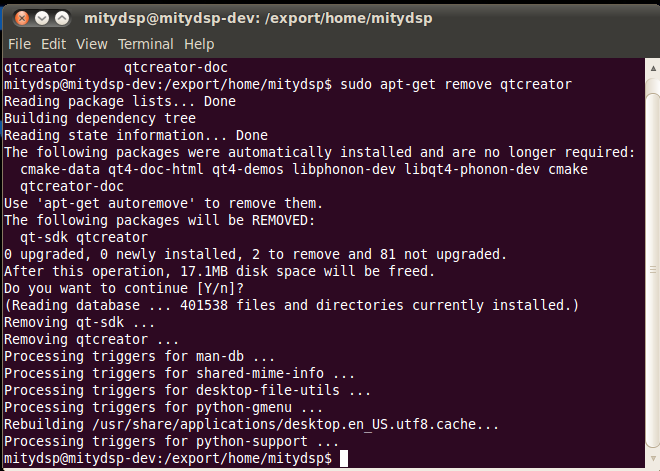

Setup QT Creator¶
Install qtcreator version¶
- Open firefox in VM
QtCreator 2.6.2 seems to be the latest version of Qt Creator that can run in Ubuntu 10.04
- Download QtCreator 2.6.2 linux-x86
Attached to page in case mirror goes down. qt-creator-linux-x86-opensource-2.6.2.bin
