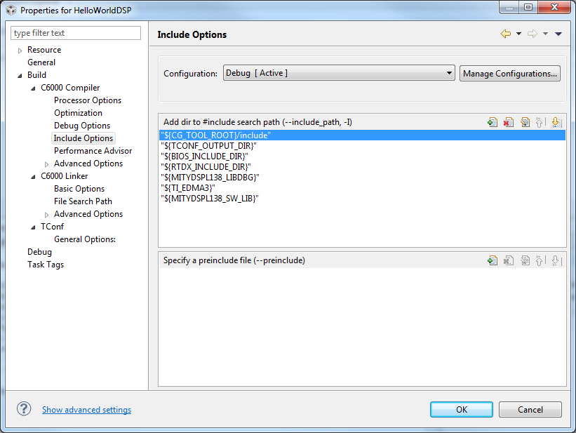

  • Specify the project Include Options
    • Right click on the project and select 'Properties'
    • Expand 'Build'
    • Expand 'C6000 Compiler' and select 'Include Options'
    • Add the appropriate directories, or the Environment Variable(s) you created in the above step (i.e. "${MityDSPL138_LIBDBG}"), to the Include Options. Note quotes are important.
      "${MITYDSPL138_LIBDBG}"
      "${MITYDSPL138_SW_LIB}"
      "${TI_EDMA3}"
      "${TI_EDMA3}/ti/sdo/edma3"

    dsplinkk.ko as well as other libraries can be found on the target in the the /lib/modules/3.2.0/extra/ folder.
  • EM Added by Edwin McKay over 10 years ago
    Not sure where to add this, but when going through these steps on Linux, I found that the $[TI_EDMA3} and the library link paths were not correct. The TI_EDMA is set to ${MDK}/sw/3rdparty/edma3lld_01_11_00_03/packages/ti/sdo/edma3. Then the library paths in the text box include "ti/sdo/edma3" in their paths, so if you cut-n-paste from them it will not link correctly (since ti/sdo/edma3 is in the path twice. The image is correct, but you can not cut-n-paste from it. FWIW.
