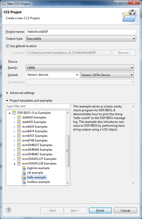

Create a new CCS project¶
- File->New->CCS Project
If CCS Project isn't listed, check under Other -> Code Composer Studio.
- Give the project a name
- Set 'Output type:' to 'Executable'
- Set 'Device Family:' to C6000
- Set 'Device Variant:' to 'Generic devices' followed by 'Generic C674x Device'
- Expand the 'Advanced settings menu':
- Set 'Device endianness' to 'little'
- Expand 'Project templates and examples':
- Inside 'DSP/BIOS v5.xx Examples' open up 'evmOMAPL138 Examples' and select 'hello example'
- Click 'Finish'

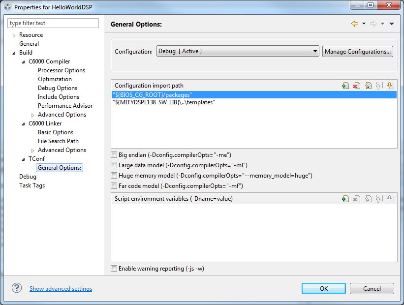

- Specify the location of ${MDK}/sw/DSP/templates directory, where the criticallink/platforms/MityDSP-L138/Platform.tci file is located:
- Right click on the project and select 'Properties'
- Expand 'Build'
- Expand 'TConf' and select 'General Options'
- Set to the path to the location of ${MDK}/sw/DSP/templates on your machine, which contains contains criticallink/platforms/MityDSP-L138/Platform.tci
- Note: you must specify the location of the ${MDK}/sw/DSP/templates directory and not any deeper as the criticallink/platforms/MityDSP-L138/ path is expected in parts of the build process.
