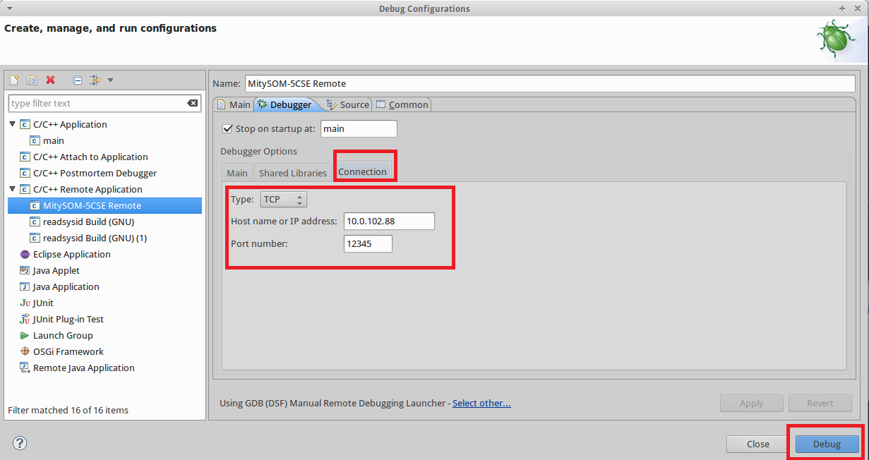

  7. We will now setup a remote debug configuration in Eclipse. Right-click on the project and select "Debug As" and then "Debug Configurations".
  8. Make a "New" debug configuration by Right-clicking on the C/C++ Remote Application option and name it "MitySOM-5CSE Remote"
  9. Choose the "Select other" option at the bottom to use a "GDB (DSF) Manual Remote Debugging Launcher"
  10. In the "Debugger" tab set the GDB debugger as shown (/opt/poky/1.5.4/sysroots/x86_64-pokysdk-linux/usr/bin/arm-poky-linux-gnueabi/arm-poky-linux-gnueabi-gdb):
    Note that previously for the Altera Embedded toolchain the entry was /home/user/altera/14.1/embedded/host_tools/mentor/gnu/arm/baremetal/bin/arem-altera-eabi-gdb
  11. Finally set the "Connection" tab of the "Debugger" tab so that the Type is TCP, the address is that of your module (10.0.102.88) and the port number of 12345. Now press the "Debug" button to begin debugging. You may be prompted to switch to the "Debug View", select OK.

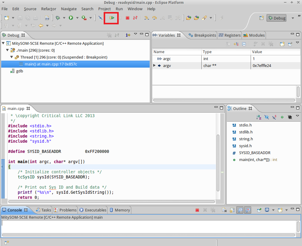

  12. Once Eclipse connects to the module it's serial port should show the following output:
    Remote debugging from host 10.0.102.102
  13. In the Eclipse debugger select the "Resume" button to allow the application to execute on the remote target (module).
  14. The following should now be printed on the modules serial port.
    FPGA SYSID - 00000003 : Wed Nov 12 21:14:50 2014
    Child exited with status 0
    GDBserver exiting
  15. You can now restart the GDBserver and application on the target module and begin using breakpoints and other debug features within Eclipse on the Host VM.
