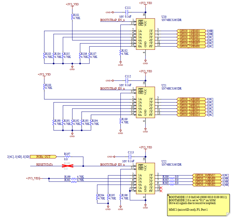

MW RE: Isolation resistors for Bootmode pins on the AM62A Mity-SoM? - Added by Michael Williamson over 1 year ago
For the bootmode pins:
1. If you are concerned about isolation, you can use a tristate buffer to drive/tristate the bootmode pins using the PORz_OUT signal from the SOM. See the schematic below as an example we used for another carrier card for the SOM instead of inline pullup / pulldown resistors.
Note that R200 R202 and R203 should not be fitted.
2. Bootmode pins 2:0 are pulled up or down on the SOM.
3. Make sure you are pulling them to the VDDSHV3 rail (in case you are not using 3.3V).
Thanks!
Mike
