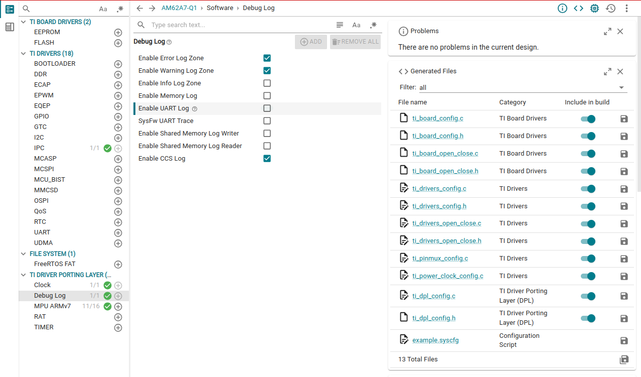

I am having some difficulty bringing up a serial port that utilizes WKUP_UART0 pins. From what I understand, it is typically reserved for DM logging and is unusuable in Linux until it is disabled. I have disabled the UART log for the ipc_rpmsg_echo_linux example is the MCU SDK, rebuilt it, and linked it in place of the old firmware in /lib/firmware.
