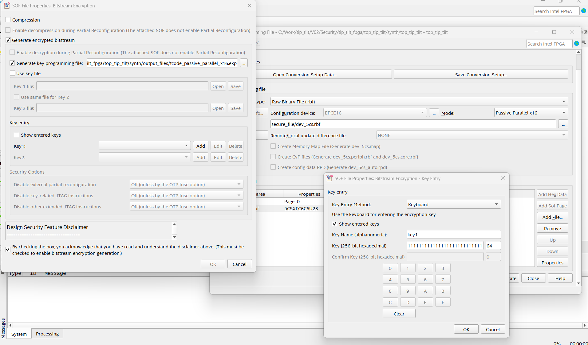

In Quartus, I enabled bitstream encryption and generated an encrypted RBF file (dev_5cs.rbf) as well as the corresponding .ekp key file (screenshots attached).

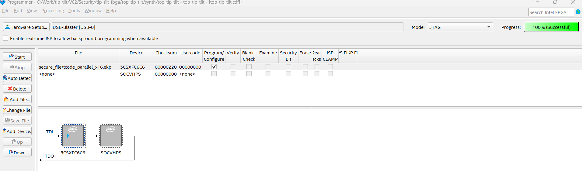

I programmed the .ekp file into the FPGA using Quartus Programmer (screenshot attached).

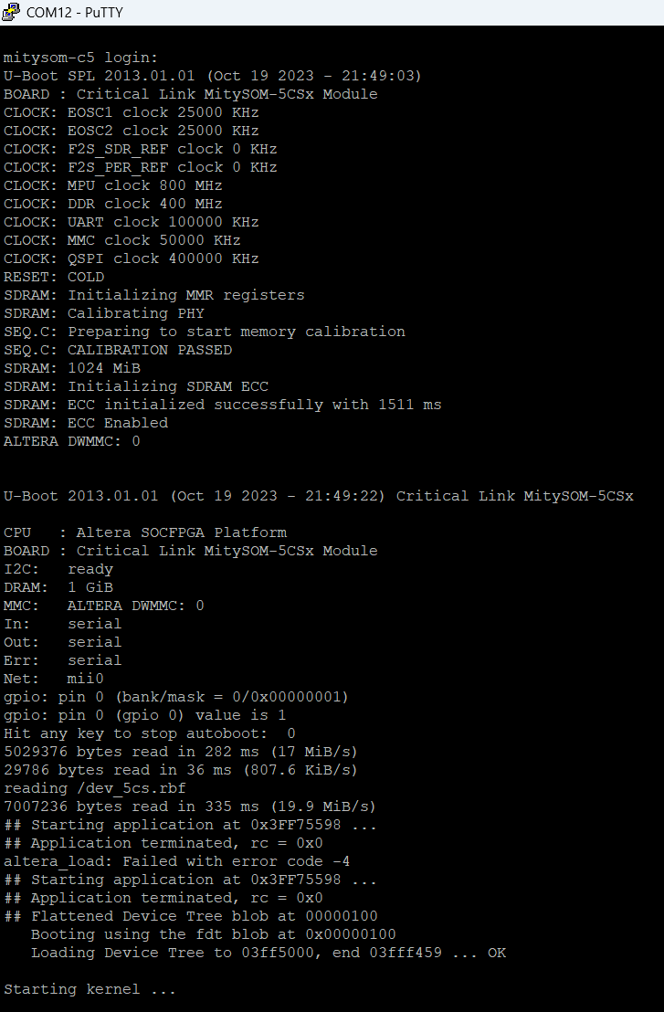

When I boot the system and monitor the console in PuTTY, the boot process stops at “Starting kernel …” and does not proceed further. If I replace the encrypted bitstream with an unencrypted .rbf file, the system boots correctly.

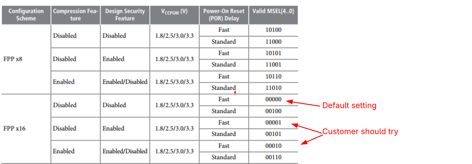

Atef,
Can you make sure you have the MSEL set appropriately per the table below?
