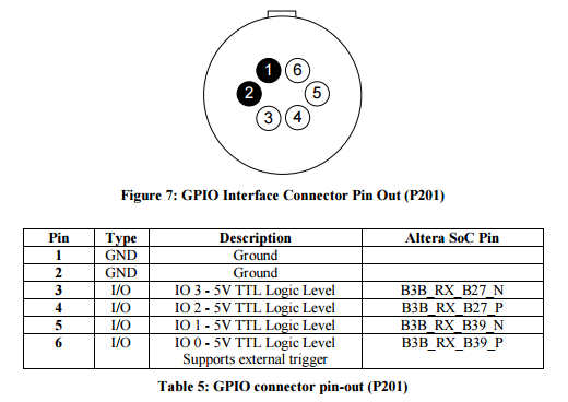

Could you provide an IO port pinout diagram for CIS1910 MityCam? I have failed finding it in manuals.

Did you check the datasheet, Figure 7 and table 5? Or is there something else that you need that is not there?
http://www.criticallink.com/wp-content/uploads/2014/01/MityCAM-B1910F-Datasheet.pdf

Thank, you. It's really there.
| ScreenClip.png (47.4 KB) ScreenClip.png | IO port pinout diagram |
