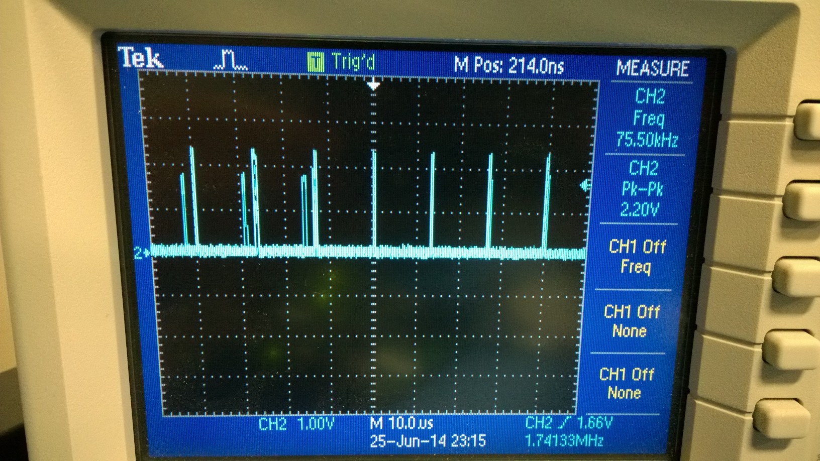

LY RE: DSP to FPGA SPI Setup Question - Added by lijun yang about 12 years ago
Hello,Mike
Thank you for your help.
I have attached two pic
----one is the SPI bits transfer rate(This is our desired speed),
----another one is the word to word transfer rate(This is slow. We want it can be fast,Could you give us some ideas?)
If it can't work, we have to try the UPP.
Could you give us some ideas about UPP?
Than you very much.
Regards
LJ
MW RE: DSP to FPGA SPI Setup Question - Added by Michael Williamson about 12 years ago
What is your target update rate? Continuous?
You might try first to rip out all of the overhead on the tcDspFpgaSpi.cpp code (there is LCK_pend()/LCK_post() for serialization control, etc) and boil it down to the register writes.
You could use the UPP, but you'd need to write your own UPP to SPI interface, which should not really be required.
You might try to write a FIFO to shift register interface in the FPGA and just write that FIFO directly and not use the SPI core.
-Mike
